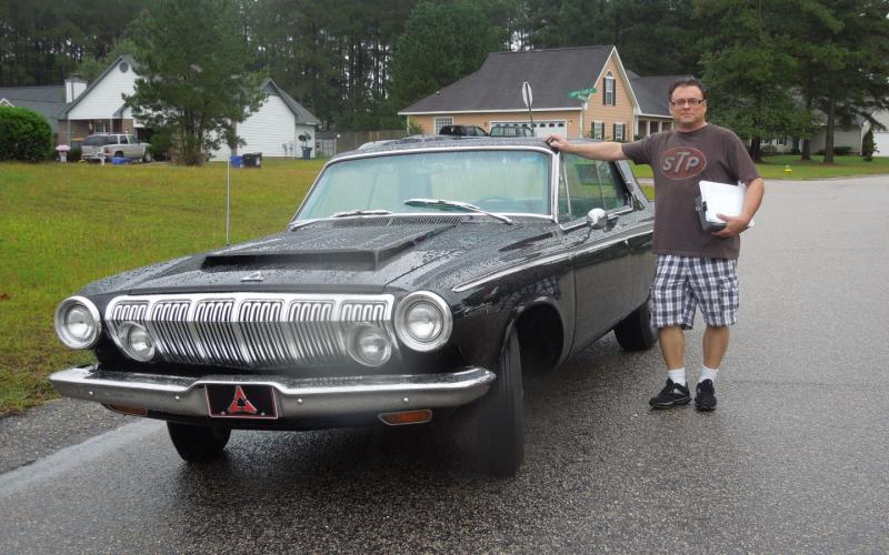

My buddy bought his dream car! :headbang:
We discovered the none of the keys the previous owner gave him work the door locks. What are his options?
