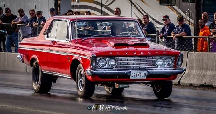

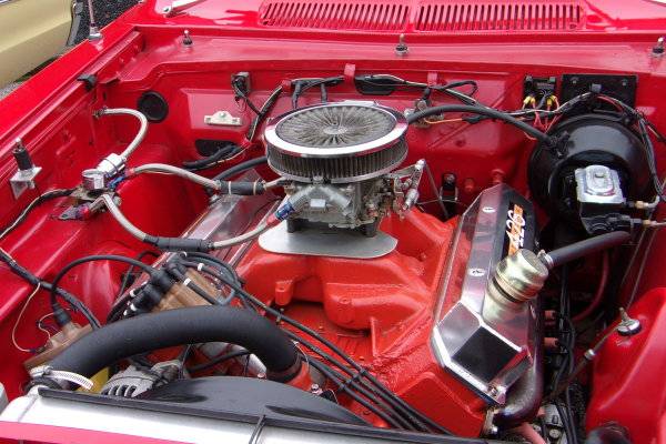

I did just that with my 63 Sport Fury. I built a 493 with Indy EZ heads and the Indy dual plane intake. I use the 2" TTI headers and the TTI 3" full exh system. I installed the eng from the top and layed the headers in the eng bay as I set the eng in. I had a friend hold and work each header up to the eng as I lowered it in. I don't have P/S as I did not want it and don't need it. Mine is an original 383 auto car and its now a street/strip car that's is 99% a street car. Nothing is modded on the body as the springs are all in stock location and its not tubbed any. Ron
Here is my car. It was simple to install the eng and headers in it. I also use the stock K-frame which works fine for me. If I can help with any other info just let me know. Ron
