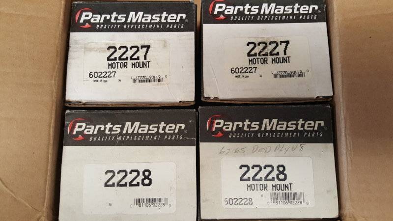

I found two sets of NOS on ebay. They're your best bet for longevity, made in usa.

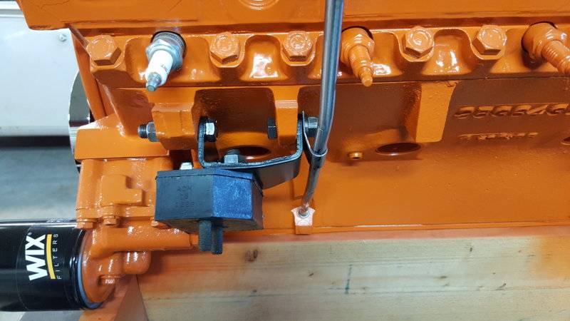

Here's the brackets off my '62 361, installed on my 440. Don't mix them up. (2228 driver's side)

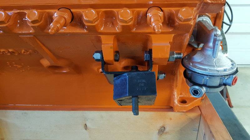

2227 passenger side
