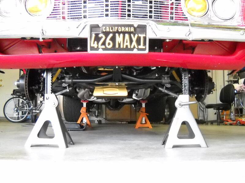

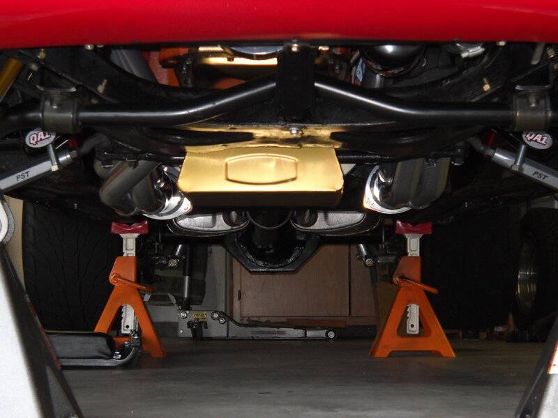

I have a FirmFeel bar on the front. Didn't find a rear one listed for a 63...
