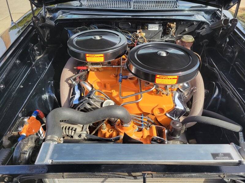

My 63 Sport Fury with a 440 block and Max Wedge parts (2x4 crossram, Wedge exhaust, etc) starts up fine and after a 5 to 6 mile drive when it is turned off it will not restart. It cranks over but wont fire. It keeps cranking until the battery runs out of juice. I can hear the electric fuel pump running. If I jump start it it will fire right up. Battery is new and is mounted in the trunk. Any thoughts?
