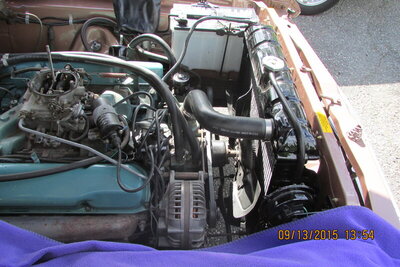

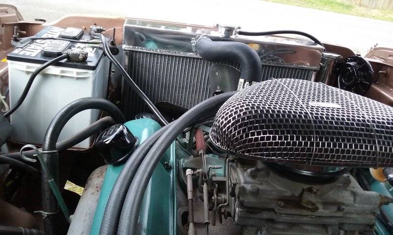

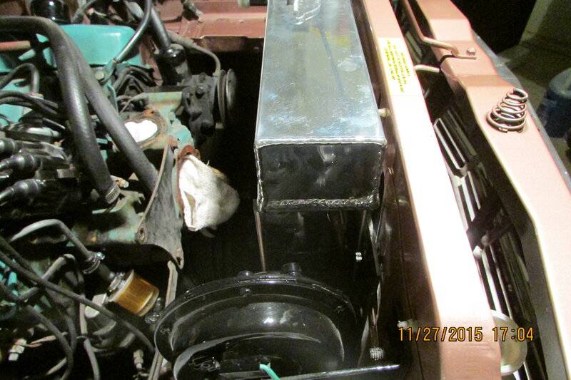

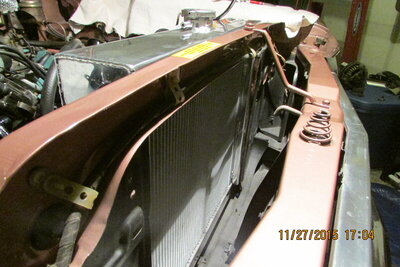

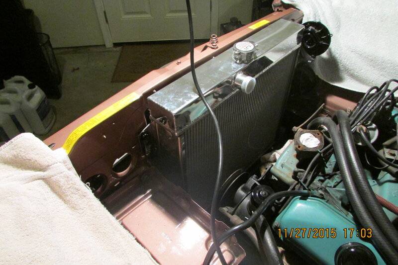

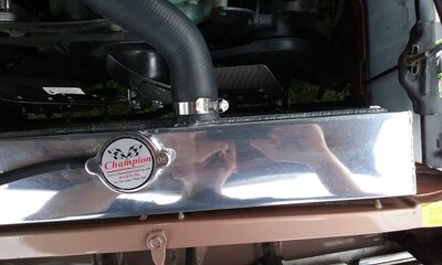

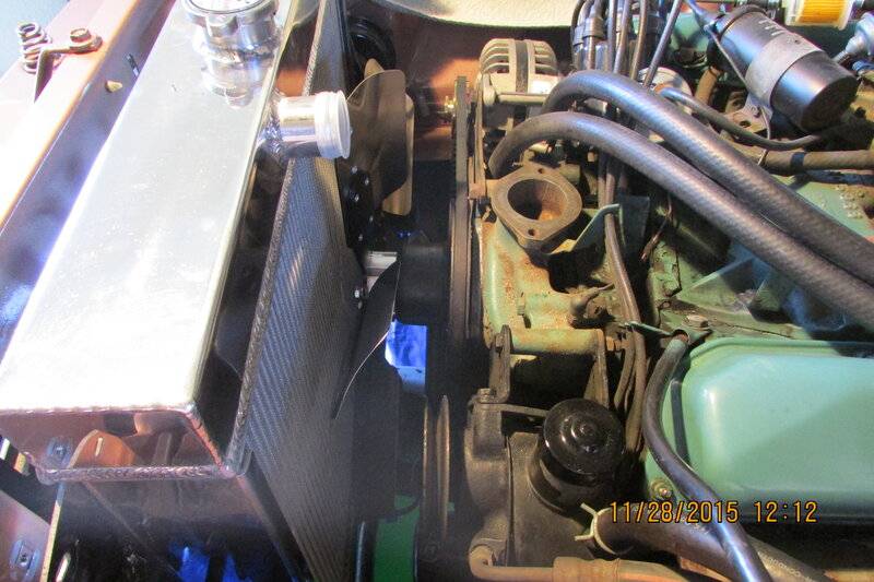

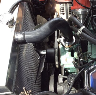

Champion makes a nice radiator that was an easy install.
The only modification was grinding the slight curve out on the left side flange for the battery tray. Over 6 years in service and not one cooling or leakage issue to date.
Hope this helps you out with options.
