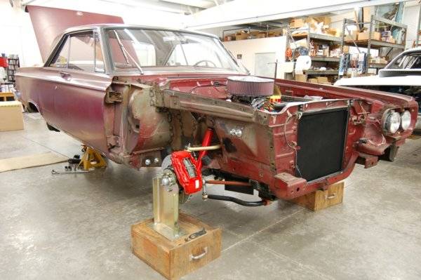

I used Firm Feel upper arms on my '65. Stock ones will also work with the late model knuckles.
Stock arms with the offset bushings in the front. If installing the offsets in the rear make sure you trial up arm to shock tower clearance. Many times the arm will touch. Both my sons car and mine run with offsets in the front position with stock arms. About 2.5 + caster. Both cars run between 142-151 mph. Both steer and drive great.
