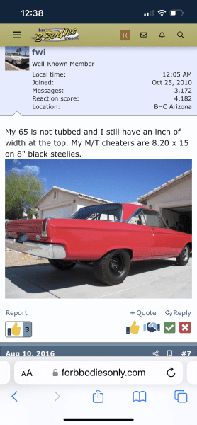

Hey guys. I want to run some Pie Crust cheater slicks on my 64 Belvedere. Wondering the optimal size to get. Stock wheel well. I have 15x7 steelies but would get 15x8’s if better. Going for this look. Thanks.
Russ.
