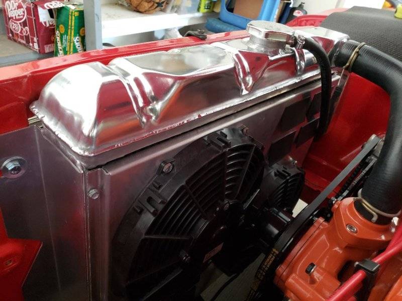

about my car....64 Belvedere with a 496 11.5-1 A&A Cross Ram Edelbrock AVS2 Comp hyd roller cam(can't remember the exact specs off hand something like 540 lift and 312 duration) roller rockers. Standard flow water pump (crank and water pump pulley are the same size) 180 stat Griffin alum radiator with 2 elec fans 410 Dana 60 with a Detroit locker......dynoed 532 hp at the rear wheels. The problem I'm having is when I'm driving in NON stop and go traffic anything over 40mph the temp goes to 210....but if I'm in heavy slow traffic it stays down around 190. The fans come on at 180 and stay on til temp goes down to 160 which never happens. This is backwards from what should normally happen. Any thoughts on what I may have overlooked???? I just picked up a hood to radiator seal but don't have any holes in the core support but can/will drill them in if this will help keep the car cooler but what I would like to see is some pictures of the seal mounted as well as pics of where the "ears" at the end of the seal go....any help or suggestions would be appreciated.....thanks, Mike

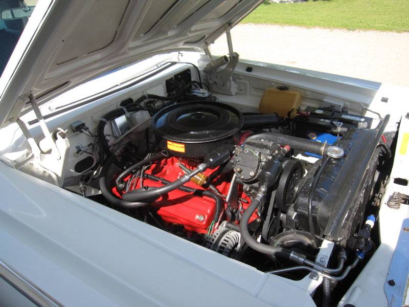

Mike,

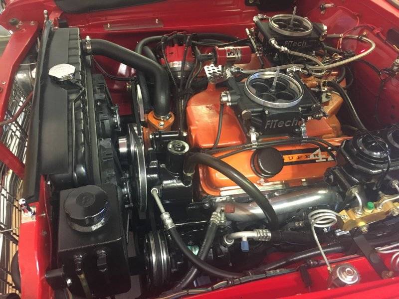

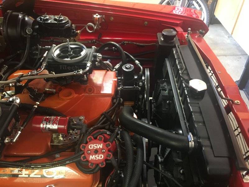

I think the 65s are the same so here's a couple photos of my 65 Coronet.
Mike
