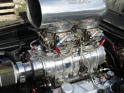

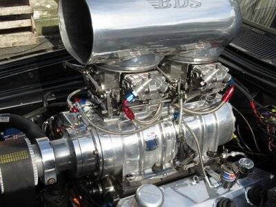

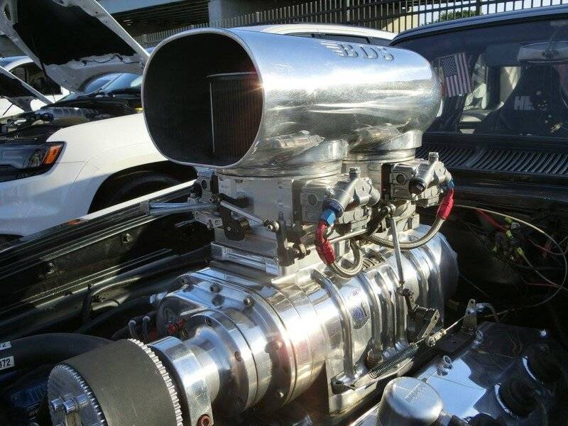

I have the +1” with a 426W and a CH4B. Fits well. The original would simply not work. My best guess is this would work and the +2” shouldn’t be required. Got mine from Mancini.
I like the Lokar,cut to fit is a wonderfull thing.

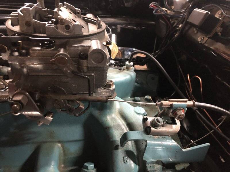

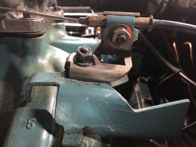

I ended up ordering one from Mancini’s that was 1” over stock and it should fit perfectly. I can also use all original Mopar throttle brackets even with the 1” taller Holley Street Dominator intake by adding a cruise control bracket to the existing bracket and putting the throttle cable in where the cruise cable would normally go.
