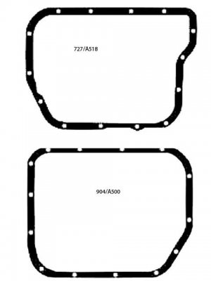

I have a 67 Plymouth belvedere with the 273 V8. I am curious as to what transmission and rear end is in the car. All I really know the rear end has 3.23 gears and the transmission is a 3 speed automatic. As far as I know the engine, transmission and rear end are the originals that came with car. Any help would be appreciated.....Thanks
Shouldn't be too hard to determine the rear. It's most likely an 8 3/4.
The trans pan will tell you what's in there. The 727 has an offset sticking out on the front right side and the 904 has a more of a square pan. Someone posted a pic of it here somewhere lately...
Thanks for the information. Maybe somebody can tell me what the transmission is.
Here's what the gasket looks like and so the pan follows the same pattern. Just get under the car and take a look. You can easily see the difference when looking from the passenger side. The top of the pic faces the front of the car....
