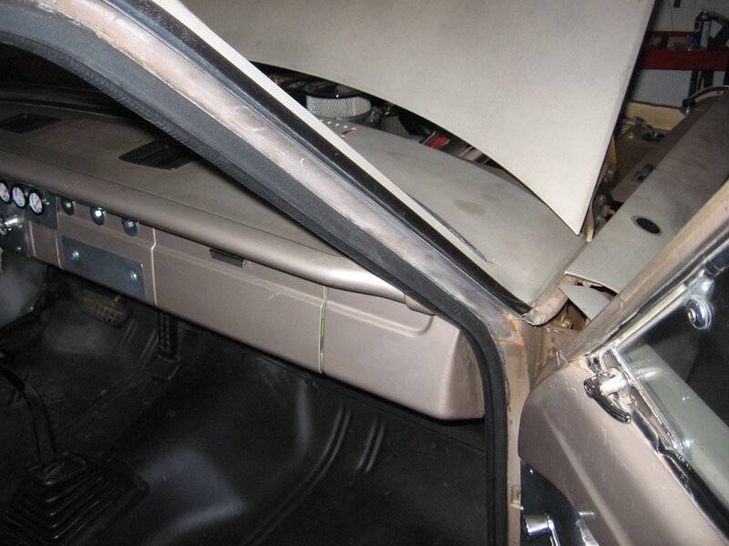

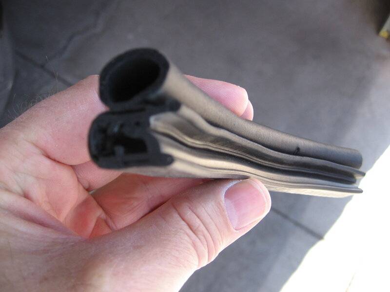

I had a not nice experience with aftermarket crap, a suggestion was to install and keep doors closed for a week to create a set. Meant full squat and ended up damaging my door jam gear so had to find another. Should a sent the supplier a bill for my new door gear. Viewing the photos…aha…oh sure this was gonna fit…

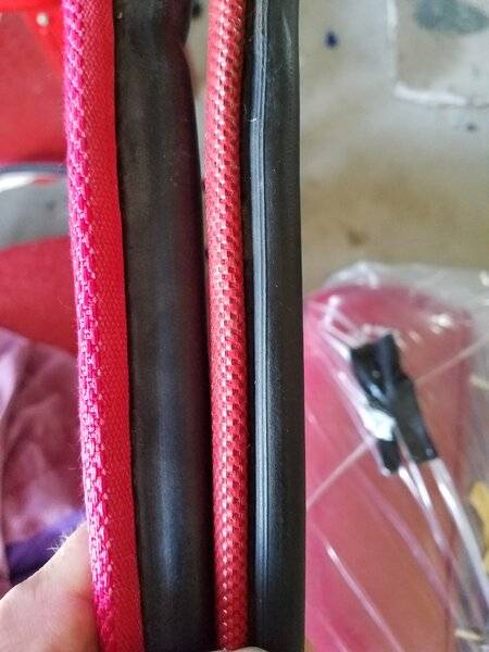

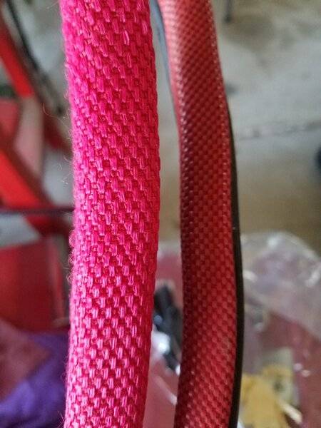

If you don't care if it has cloth on it,, I ordered seals for a 88 Dodge Ram truck from Rock Auto.
It comes long enough to do the car doors. Best part it was only $13 a door. No problem with the doors closing.
I did a 64 2 door sedan Dart first then my 63 Belvedere 4 door sedan.
If you don't care if it has cloth on it,, I ordered seals for a 88 Dodge Ram truck from Rock Auto.View attachment 1116308 View attachment 1116309
I like that! $150 -$200 a car gets expensive if you have 3!!! Maybe I would be able to get all the doors to actually completely shut too!!! Thanks for the tip!
Hey it worked for me. Found out by accident.I was looking for them for my 88 truck.
