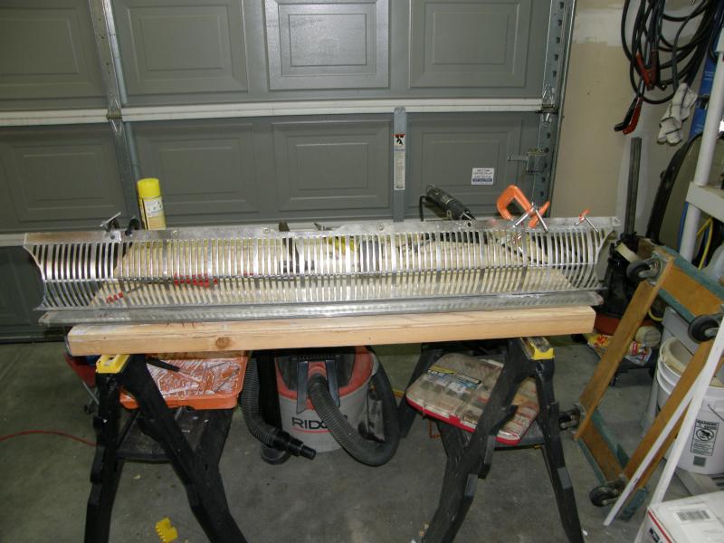

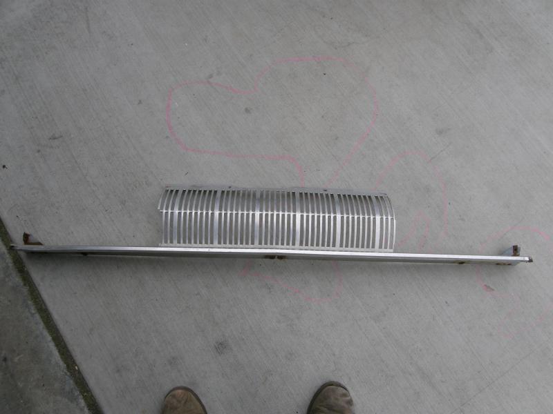

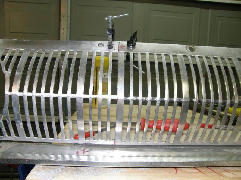

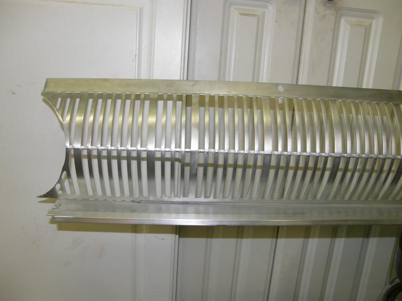

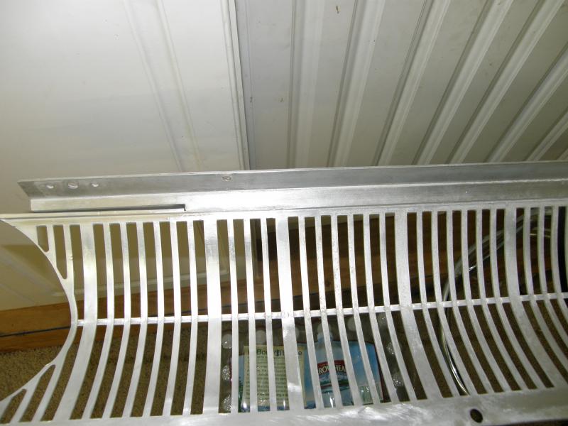

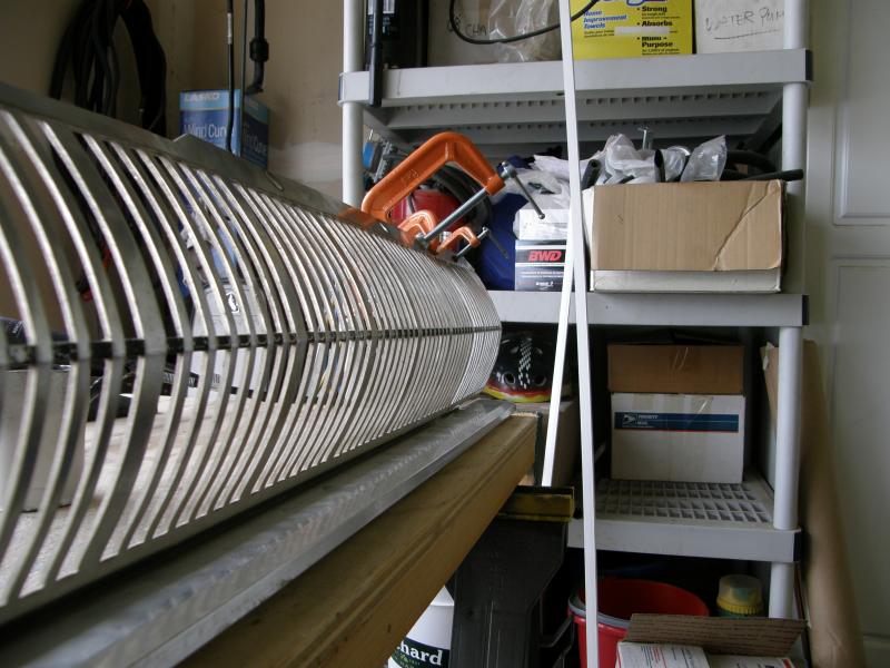

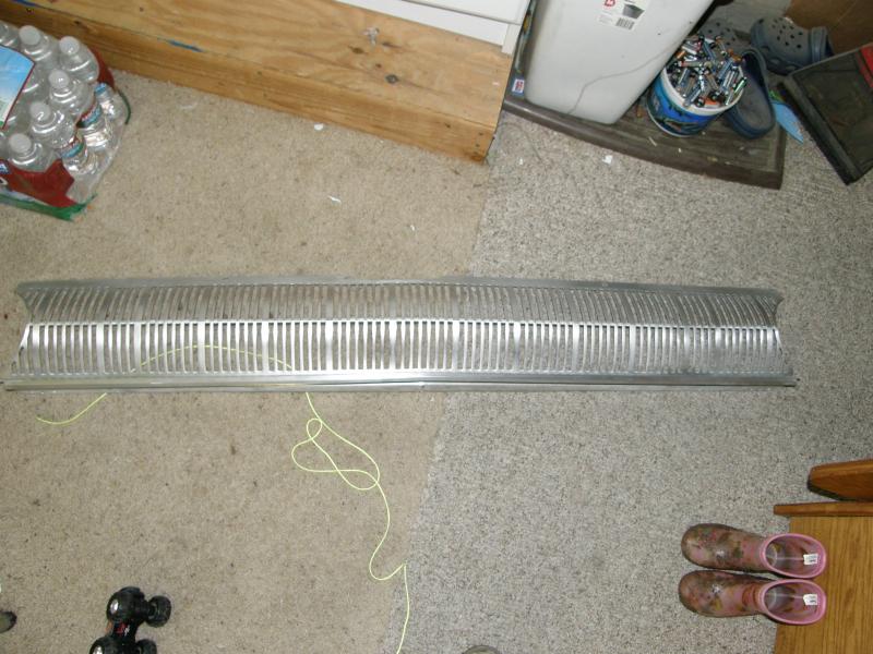

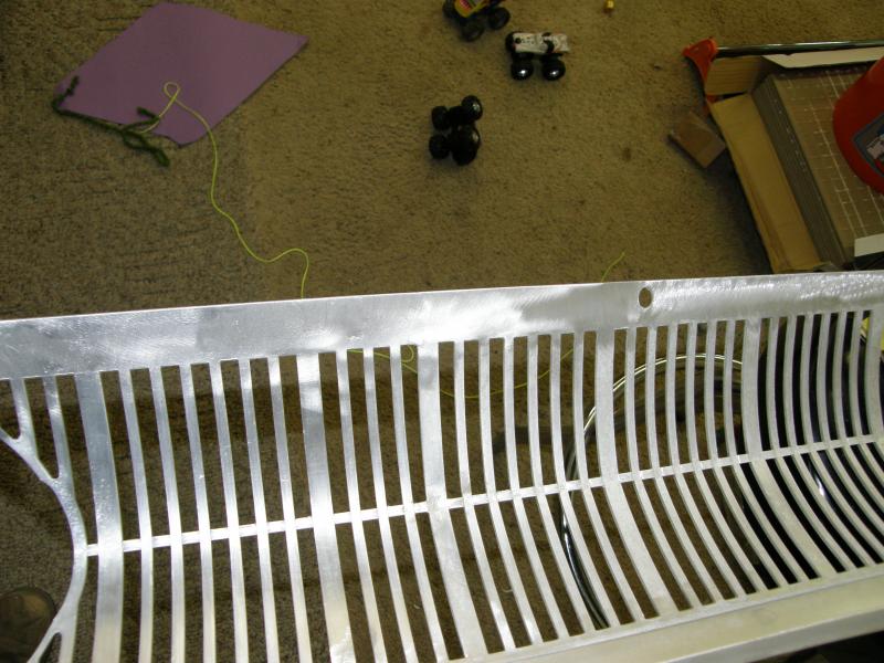

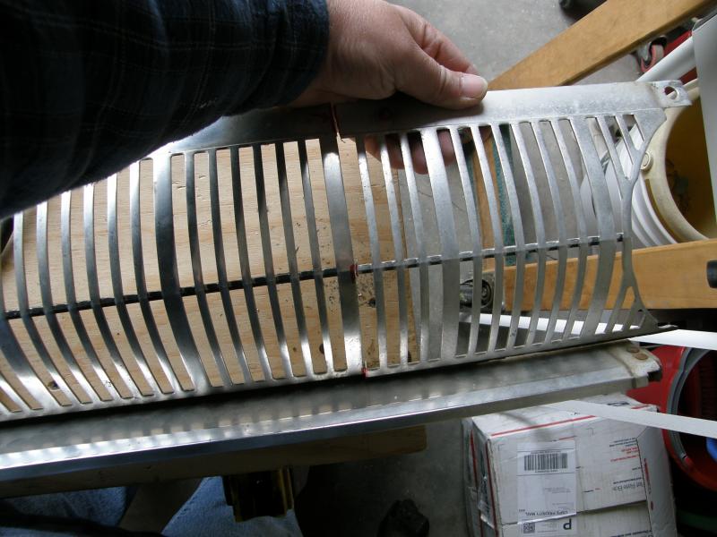

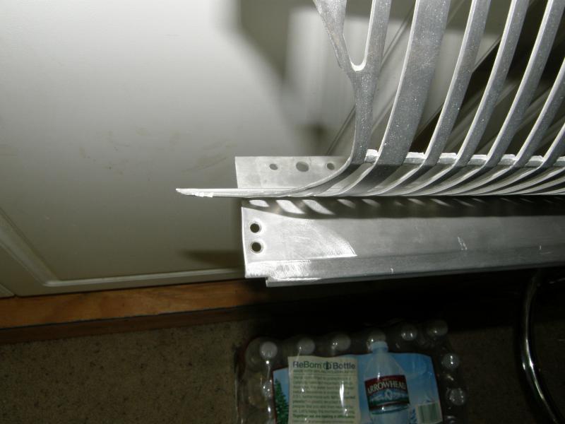

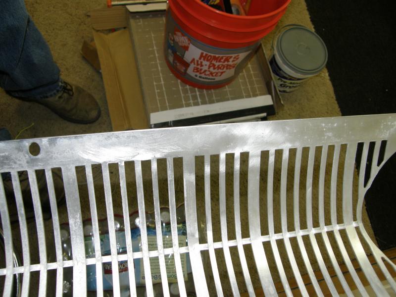

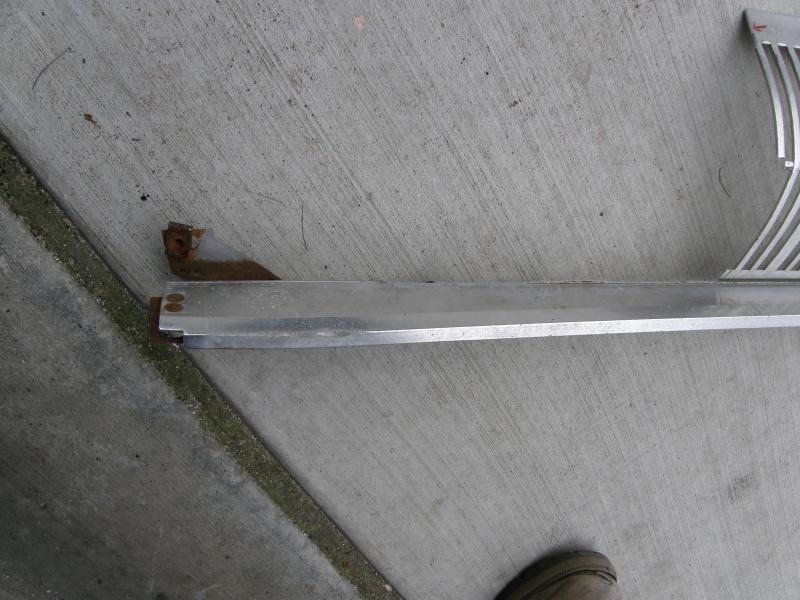

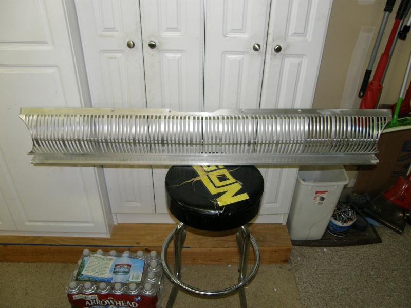

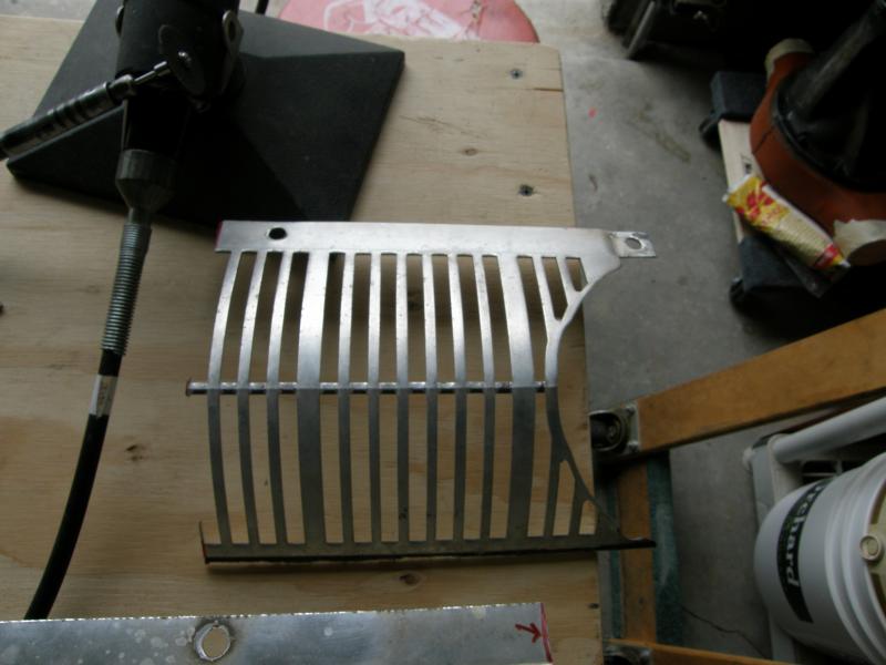

Well late today I got started on making another superstock grille. The passenger side is cut out and was able to get the additional piece mocked up. It still needs some fine tuning, but the fit is almost perfect. Hopefully tomorrow I can get some time to do the drivers side and snap a few pics to "show the progress". I will not be sending it out to be bright dipped like the factory did, instead it will be a full polish and the painted black area's re-done like the factory.
Making a superstock grille

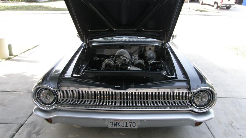

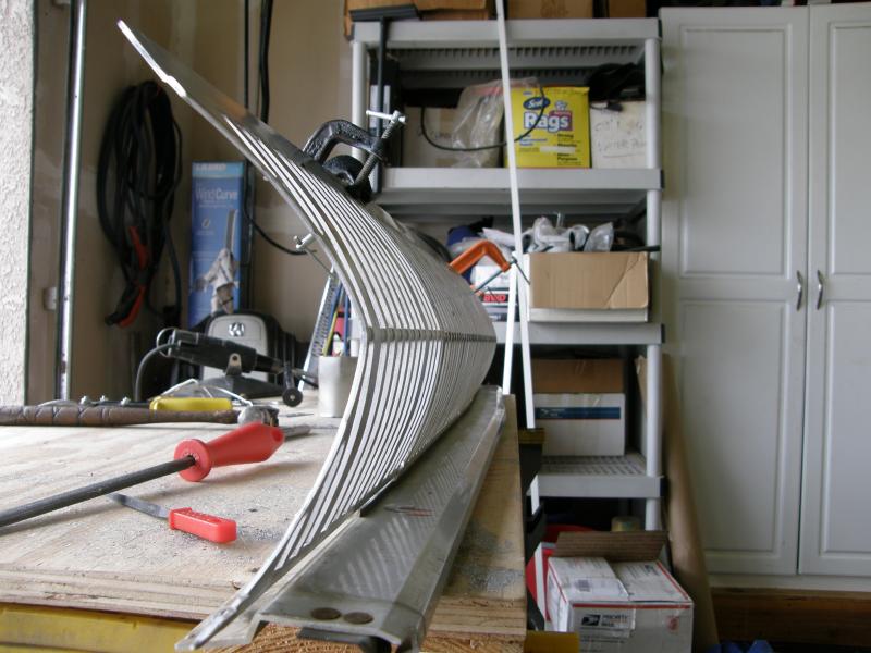

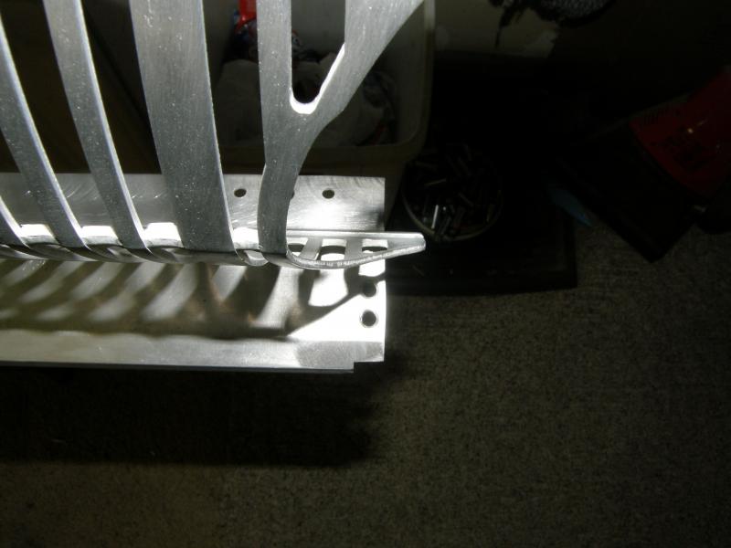

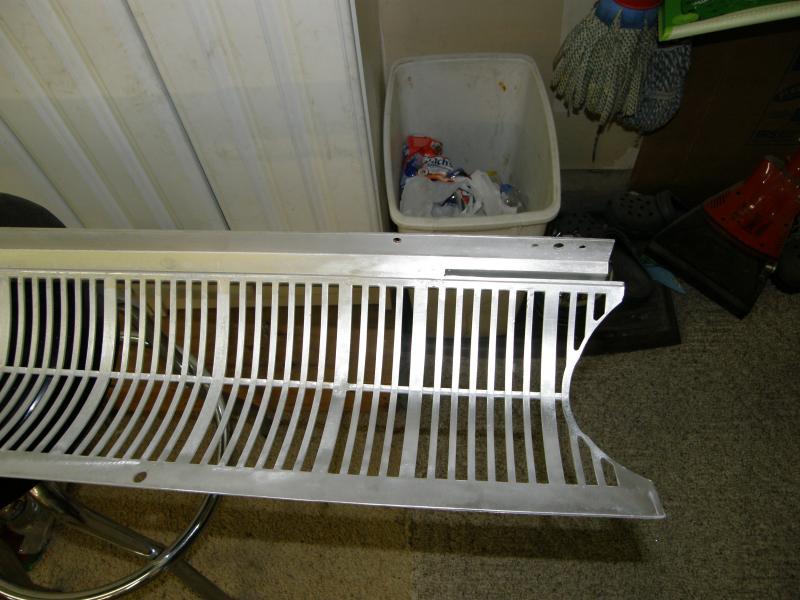

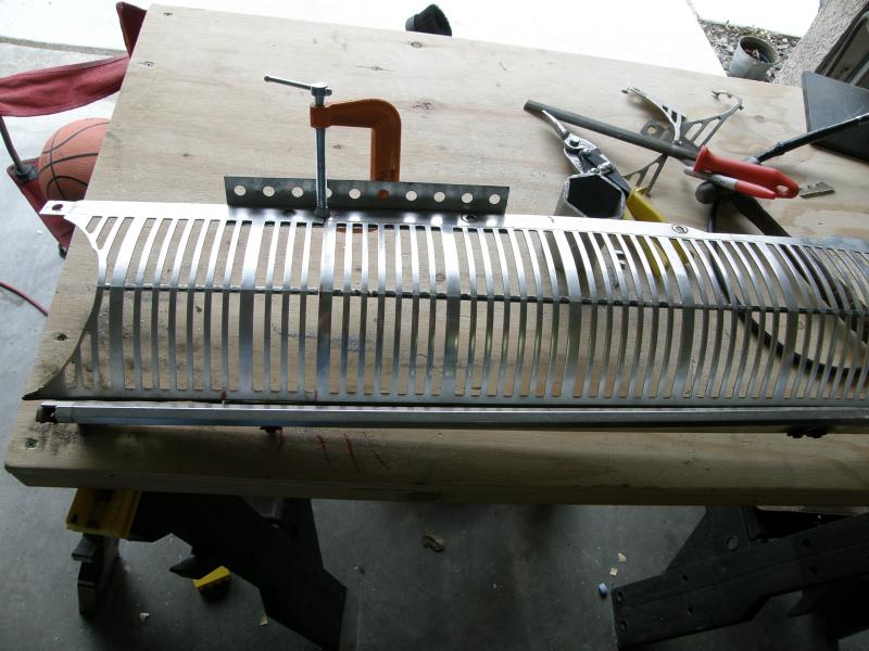

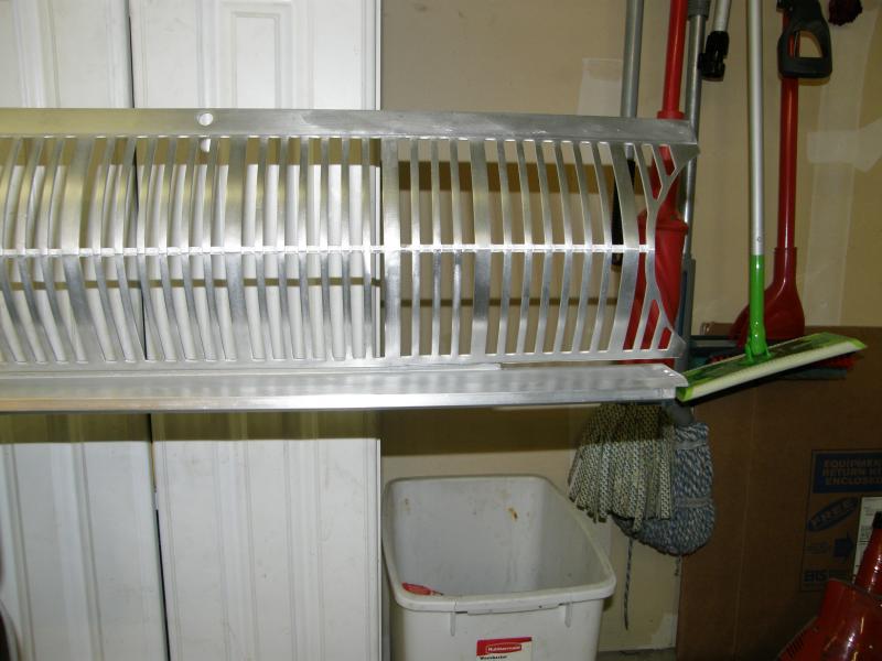

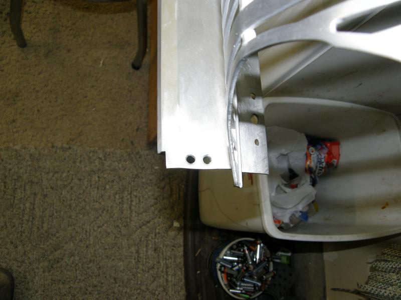

I got some time today to work on the grille. Just so everyone is aware, it takes 2 grilles to make 1 superstock and hopefully if done right, ya got something worth having on your car, if not, ya just screwed up 2 grilles.
So let the show start..... last pic is of my grille that was done a few years ago

I like the "factory" look of the '64 SS grille compared to the somewhat "cobbled" look of the '65 SS grille.
Yeah, doing a 65 grille to the ss style leaves it looking alittle "hooky", but that's the way they were done back then.

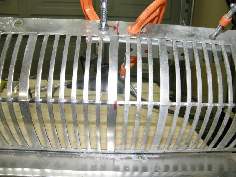

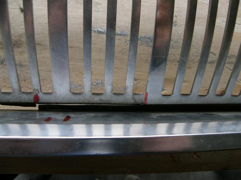

Got the grille tig welded today. Now the fun part starts.....fileing and sanding, repeat......
Honestly, I'm not sure. There are still alot of variables (insert potential F*** Ups) so I cant say for sure. When I get closer to being finished, which should be by late next week, I'll have a better idea and will post it in the "for sale" section.
I spent 4 hours today grinding down the welds, and 2 more to go. My compressor, dremel, files, and fingers were begging for mercy towards the end of today, but hey, it'll be worth it. The factory rivets on the lower outer most part have to come out to get the finish perfect, so I'll replace them with new rivets that will look factory.
I'll post pics of the progress and the lower rivets in the morning so everyone can see how's it coming along.
always liked the look of the 64 ss grille, if i had my old 64 dodge i would have done that to mine. nice work.
i guess they never used rivets like the 65 dodge
The outer most part of the grille has 2 rivets holding a metal mounting tab, but to do the sanding and polishing, they gotta come out. I will replace them with something similar as not to take away from the overall look of the grille, (more pleasing to the eye).
I got all the welds taken down and now ready for some 220 wetsanding then go up in grits til I hit 2000 then buff the holy crap outta it.
