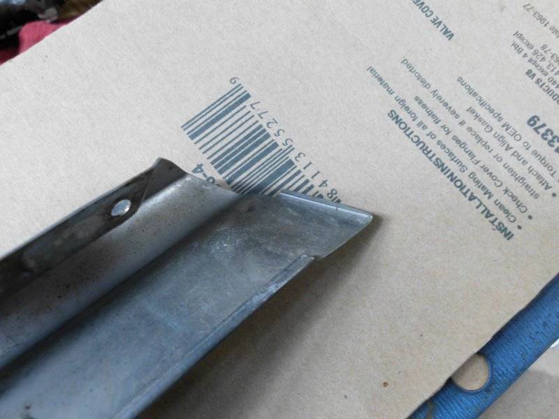

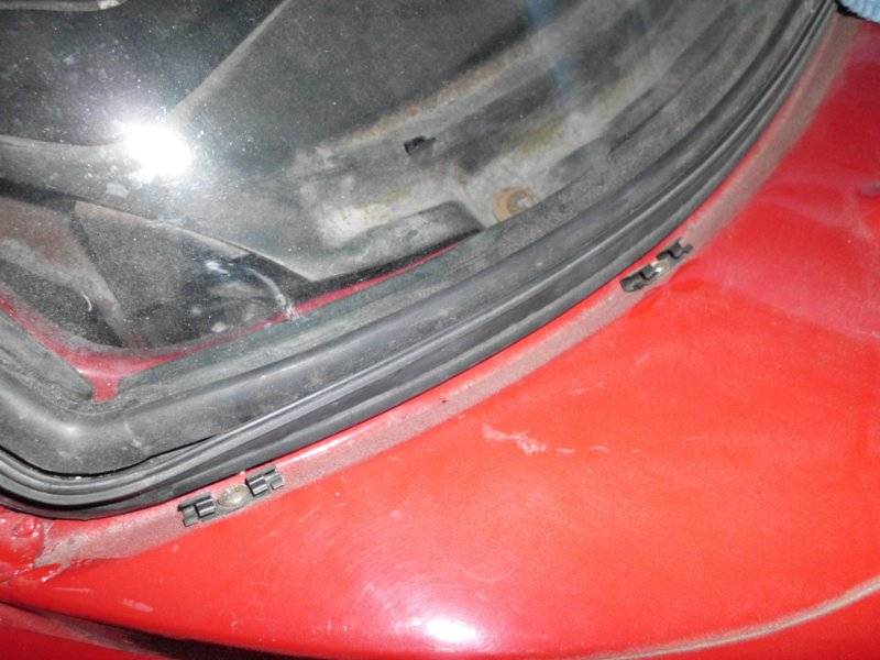

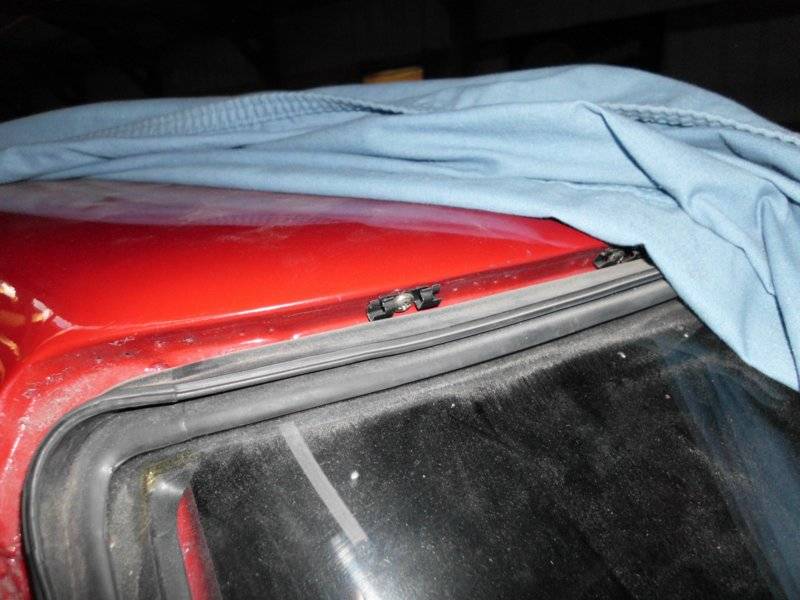

[Here are the bottom and top front windshield clips installed. They are the same.

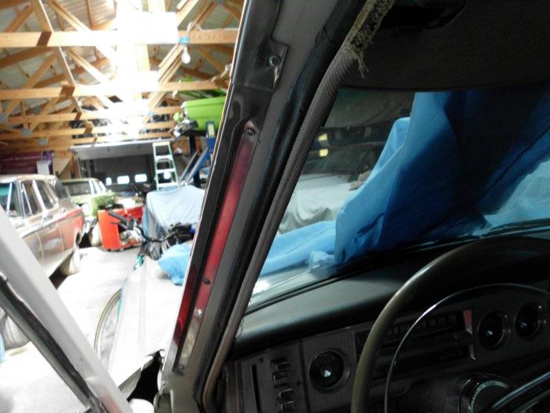

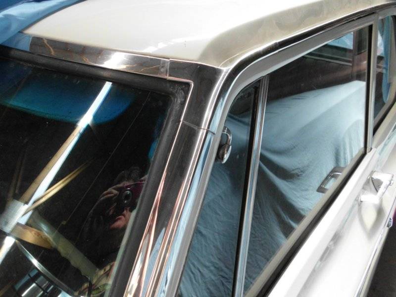

There are no clips on the side trim for the windshield. They attach by screws inside the door jam as shown. There's also a little lip at the bottom of the side pieces that sort of hooks the lower windshield trim. The top end is held in place by the part that also grabs the top trim and meets the drip rail trim.

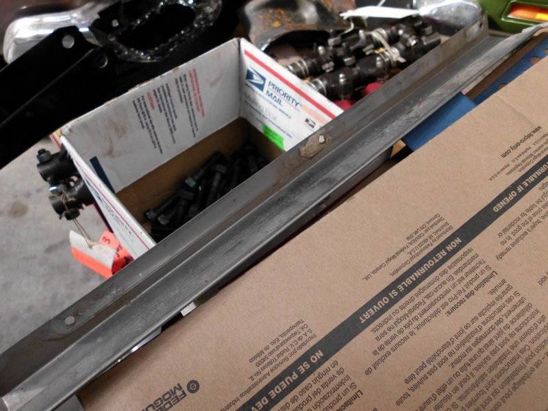

The rear windshield trim on a 64 sedan is a completely different animal. The pieces are held on by screws. If you need photos of those I can shoot some for your info. They are virtually the same in appearance on the 65 sedans as well. The 63 sedans and hard tops have similar rear windshield trim to the 64 and 65 sedans, while 64 and 6t hardtops have clip on trim.
Edit: I started thinking about this and had a chance today to check. I gave you some bad info regarding the rear window.
On a 63, all the trim pieces around the rear window are held by screws. This trim looks similar to, but is actually different than what's used on the 64 and 65 models. These two years DO have some clips securing the trim. The bottom piece along the base of the rear windshield is secured with screws.
If you need, I have a 65 sedan without the rear window trim installed and could post some photos of how that looks.
