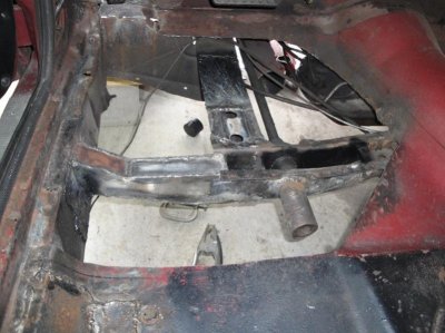

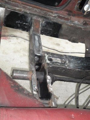

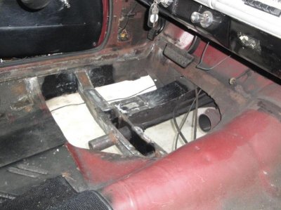

Figured I'd start posting progress. Bought a 64 Polara 500 that supposedly needed no body work. BWAHAHAHA. Underneath 150 lbs of undercoat, the driver's side subframe was "repaired" with microthin sheet metal. I burned off the cheesy welds and removed what turned out to be the entire subframe section from the center piece to the rocker panel. Inside face of rocker panel also paper thin. Overlaid same with 3/16's patch and fabbed up a new frame section using a subframe overlay kit which I sectioned, welded and installed as the all new sub. The replacement sheet metal is thicker than 3/16 but not quite 1/4, 7/32 maybe?? Fully boxed the whole thing for additional strength. Next I'll be adding the same overlay kit to the passenger side and subframe the front to rear using US Steel kit. Also will box all four corners at firewall and rear wheel wells. I don't enjoy welding so, at this stage of the project, I'm not having fun.

Back pretty much healed up so I can work with heavy stuff again. Got the subframe in on the driver's side and I'm now reinforcing the stock subframe on the passenger side. Hope to finish all reinforcement and subframe install by the first week in Jan 16. I dislike welding so this is a huge PIA.

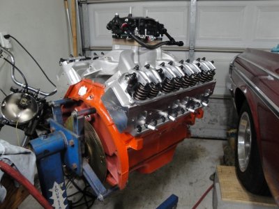

Longblock is finished but have to put an aftermarket high volume oil pan on it. Once that's done I'll start the drivetrain swap. Here's the 512 thumper with Trick Flows, Hughes rockers and Quick Fuel 850. Unfortunately, I'll have to pull the car out of the garage to do the swap and it's Africa hot outside right now. Don't know how anyone survived in Louisiana before AC.

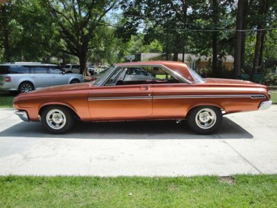

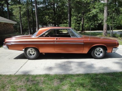

Well, haven't updated in quite a while. The Polara is up and running after much effort and $$$. 512 in the engine bay but had to remove the carb spacer for hood clearance. I'm not going to punch a hole in a perfect hood. May get a fiberglass piece later that I can chop up to my hearts content. TTI step headers installed with TTI intermediate pipes with xover. Modified 727 installed with Turbo Action Cheetah SCS shifter. Cable is tight between trans and tunnel but I made it work and kept it away from hot pipes. Large secondary trans cooler hung in front of the radiator. Had to cut the radiator support frame 1.5 inches on each side to install larger race radiator with electric fans. I tried everything(i.e wasted $$$) and there was just no way I could keep that 512 cool with the stock dimensions. $1800 later it stays at 185-190 with 95 deg summer heat in stop and go traffic. Beautiful work from Wizard Cooling.
Front suspension got reinforced stock lower control arms (which I welded up myself), adjustable lower control arm struts and Tubular uppers with larger torsion bars from Firm Feel. New ball joints, Tie rods, idler arm, and stock lower control arm bushings installed. Borgeson power steering box installed and works great but my power steering pumps are giving me trouble. I'm on my second one and haven't figured out the problem yet.
Rear suspension got new front leaf spring hangers with reinforcement plates, new rear shackles with urethane bushings and caltracs (threw out the pinion snubber) . 742 center section got new Eaton Tru Trac with 3.73 gears and a 4" aluminum drive shaft connecting front to rear with1350 u joints.
Boxed the body with kit from US Steel and installed subframe connectors. I do all mechanical work buy have body work done by local guy. Hes a whiz with sheet metal but does "OK" paint work. Replaced rear lower quarters and both inner and outer wheel wells. Got rid of all the bondo and BS that was put on the body in the last 52 years. He had to fab a lot of the inner wheel wells and did a beautiful job. Paint work came out OK but could use to be resanded and another shot of clear put on. But for $7500 I think I did pretty good. He took it down to bare metal not just an overspray. Installed new windshield and rear window seals. That's another PIA job! After the subframe work was done I replaced the front floor pans and patched the passenger side rear pan. Thank The Lord the trunk was still good cause I'm pretty sick of welding. Only work left is to reinstall the interior and finish the AC system.
The car is scary fast and I never floor it without "getting ready". At lower speeds the tires just go up in smoke, at 40 and above your over 100mph by the time you loosen your death grip on the steering wheel and look at the speedo. Will go to the track eventually and get some real info. Having fun meanwhile and the dollar drain has almost come to a halt.
Wheatdog
