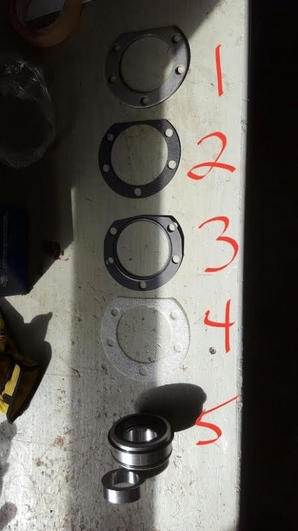

I am converting to green bearings. I seem to have a lot of parts for this job. I have attached a picture of a possible install order.
I have some questions, I labeled the pictures with numbers of the parts I think go in sequence.
I know #1 goes on first... bearing retainer. # 2 is the supplied gasket for the bearing retainer. #3 and #4 are a shim and gasket.... I don't think they are needed ? Can anyone confirm this... and lastly# 5 green bearing followed by locking ring.
Question is once again....... why do I have or need # 3 and #4... there is no shimming correct ?
Running stock 8 3/4 housing.
thx
you do not use 3 and 4. No shimming needed. Just bolt in and fill
with oil. You can eliminate the inner axle seals if you want, but I left mine in. First I would check to see if you need to remove the thrust block. Put your axles in and see if they are flush, (if they stick out a bunch do not try and bolt it down you will cause problems) if not remove the thrust block. If everything is stock you should not need to remove the thust block.

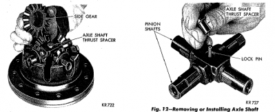

If you have a clutch Sure grip you need to remove the thrust spacer inside the sure grip. You DO NOT have to take apart the chuck. You'll need to remove from the housing. Take a long punch and knock lock pin out where axle goes in. Have a magnet handy so if you need it. The pictures are to better show the internal parts.

There is a gasket in the kit that goes between the backing plate ( white foam) and one that is meant for the original bearing retainer plate. If your going rear disk you really don't need the foam ones. It appears as if you got a bitched gasket kit that's meant to do both sides. You realize that if you have a posi, and remove the center pin the internal clutches will not release on cornering as the pin unloads the clutches by pushing one axle sideways. If your green bearings come with seals on both side you can pry the inboard seals off to allow diff lube to run down the tubes to the bearing.
If your running stock axle bearings the metal sealing gasket would go behind brake baking plate and the foam would go on outside of brake backing plate. I'd lean to putting them on a street car. Dirt and water getting inside.
If 2 and 3 are the same only use one of them per side.

For cone type SGs, Dr Diff (Cass) says no need to remove the thrust spacer. I hope he's right as I just installed the pig and am about to install the axles with green bearings.
I was going by what several guys on the Site said. Said bearing wouldn't be seated?I hope Cass is right. I have a Dana 60 with the pin in it. Had another Dana 60 guy didn't adjust the axle end play right, to tight. Removed the axle and out came half of the thrust spacer stuck to the axle. Didn't damage anything the gear oil held it on the axle.
I'm guessing that the retainer won't be flush when I insert the axle shaft if Cass is wrong. I'll give it a try and see what it looks like.
