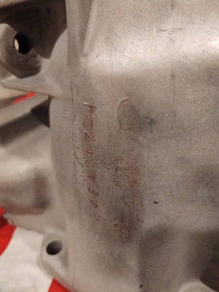

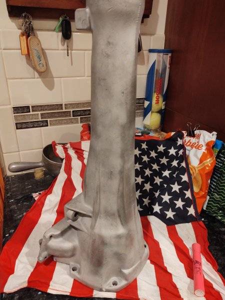

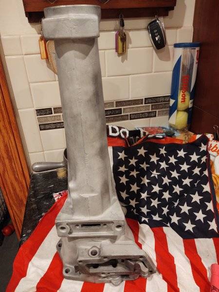

Cast in '64, for '65 model year trans.....check numbers against yours to be sure. I don't see any repairs, helicoils or stripped threads. Thx, Lefty71
