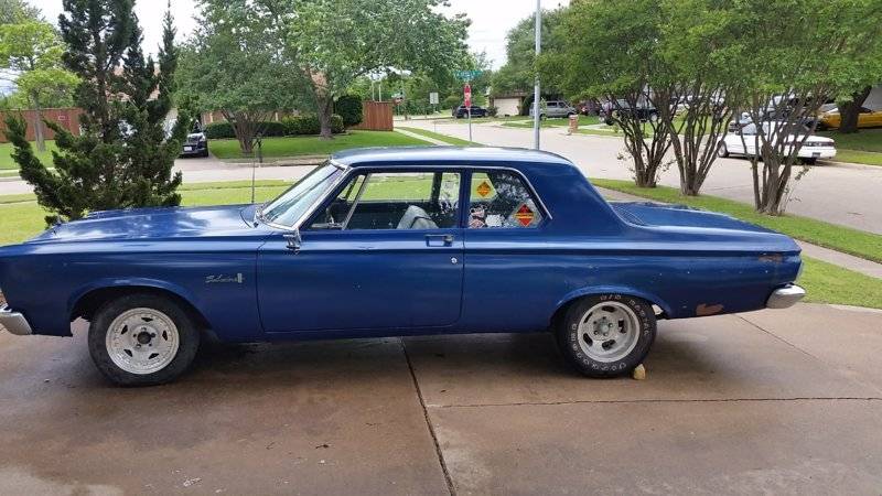

Hi guys just ordered plus 2 inch springs from espo. Looking for 60s SS look. Been searching wondering if I should of got the plus 1 since I'm using MH 9.00x15 vintage slick.. 29.5 high... anybody have opinions? I'm not sure how it's going sit since my current springs a saggin... too high? Front running 7.10x15 bias plys... I can only do this once..
thanks in advance
What year and model of car are you inquiring about? My opinion of course...Mopars sat low in the rear and high in the front in the '60's. Love the tire combo, but I think you will have a "stink bug" stance. More like a '70's look. Post pics of the car as it sits now with the saggy springs if you can. The front can be adjusted by wrenching on the lower control arm bolt. It will need to be aligned after raising or lowering though. Good luck.
You can always add blocks to bring it down.
Currently sits waiting for new shoes
I called ESPO back and got the 1". I've been reading a lot of sites and posts and have seen the cars with 1" and I figure i'll split the difference between 2" and stock. :) 2 firestone 7.10x15 bias plys and ET Vintage v wheels coming this week for the front. Gonna send them down the street to get powdercoated dary grey... I was lucky to find some 15x5.5 early b body steel wheels and now the hunt is on to get those widen. Instead of the MH vintage slicks I might just go 15x10 minitub and quicktime pro DOT.. I don't know isn't this fun? ahhahahaha
