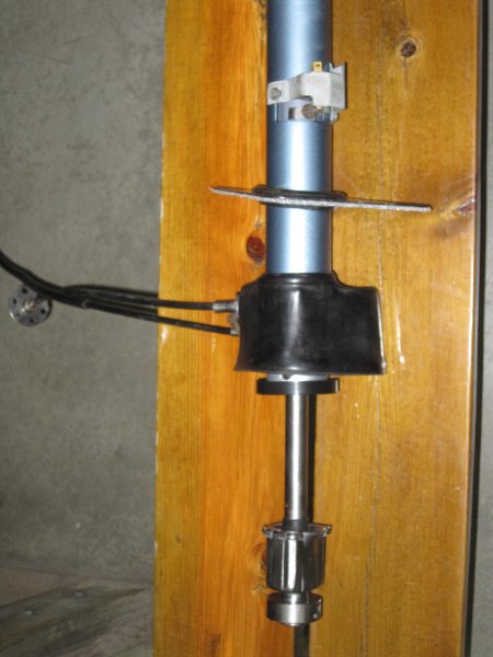

When I purchased my 65 Coronet I removed the column and restored it to factory condition. The condition of the grease in there was deplorable. Is yours OK?
