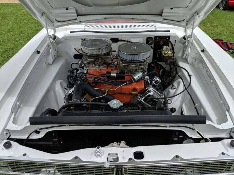

Anybody have a good photo of the hood to rad seal that mounts on the core support ?
I picked one up at the Mopar nats this week and sure as s%^t I'll put it on backwards or something.Only want to do it once. Thanks in advance !

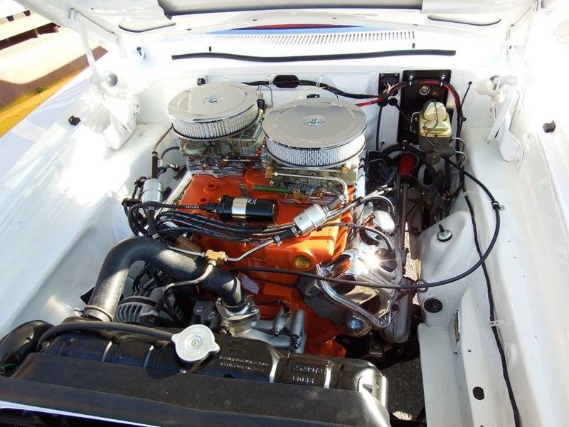

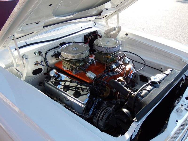

maybe these help...
Yes Sir ! I would have put it on wrong for sure. Big Help many thanks.
I had to drill 6 holes in my top bracket to house the seal and looks exactly like the one photo'd on that gorgeous car 65hemi has. I got this tip from a fellow member as part of hunting down motor cooling issues. Being **** I took my sweet time aligning it all while hating to 'drill' holes in my car. I guess some cars came equipped with this seal from the factory and others didn't...it looks just like it belongs there after it's done.
Yep, mine has the factory holes. Also they used 2 different ones, a wide and a narrow. I took the wide thinking I can cut if needed.
You have the right one...the wider one. You should see cuts are needed at the sides of the radiator for the flat end facing the engine bay and some have left the flaps to droop down. I didn't and on 2nd go I'd a left those be!
