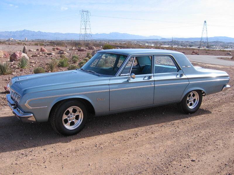

I put 16's on my 64. Hardly can tell they aren't 15's.
Wheel Vintque's with 225 70 16
