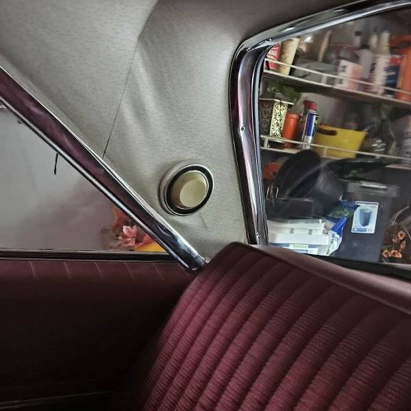

No dome light. Just one of these on each side..

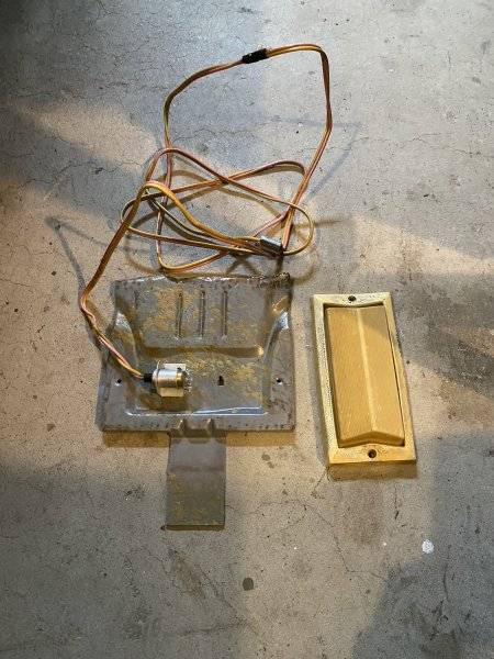

That's a hardtop. I have a spare set of those along with its wiring harness, But I have a sedan. I found a rectangle lens, but no housing which I believe is for my sedan.

Ok, I have a rectangle bezel/cover that matches the screw holes in the car roof. I'm missing the light bulb socket and wiring harness. Not sure how the bulb socket attaches to the car.

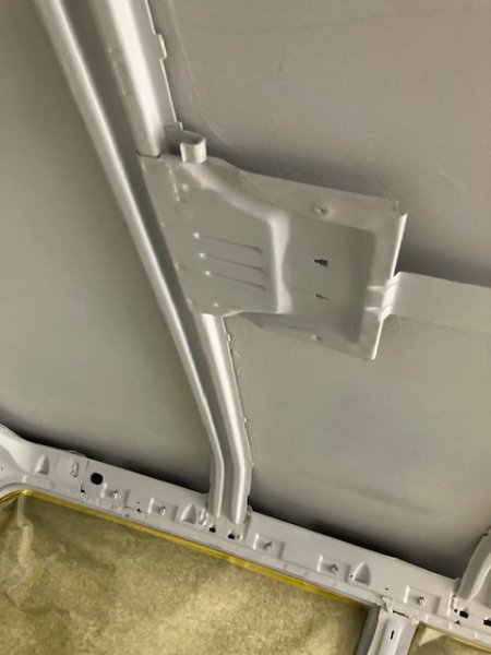

Attached photo is what my dome light bracket looks like. Anyone have a photo of the light socket assembly with the lens cover off.

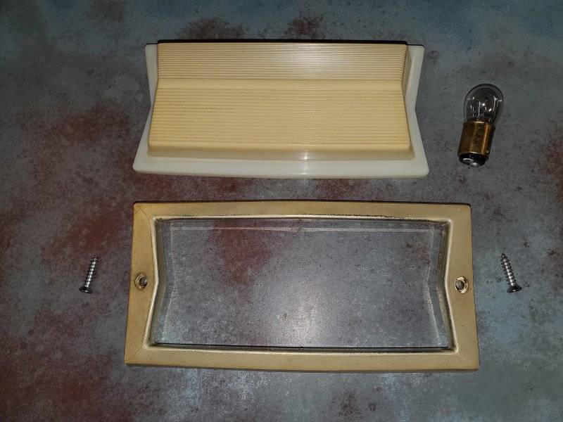

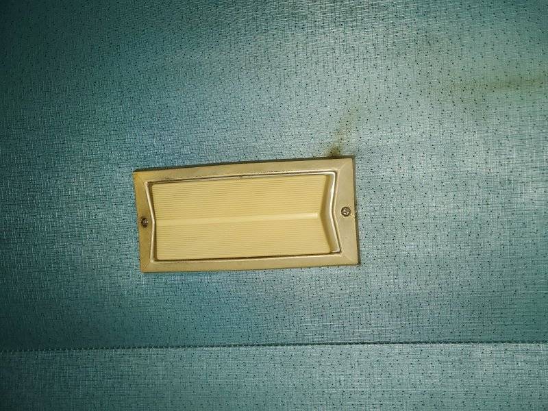

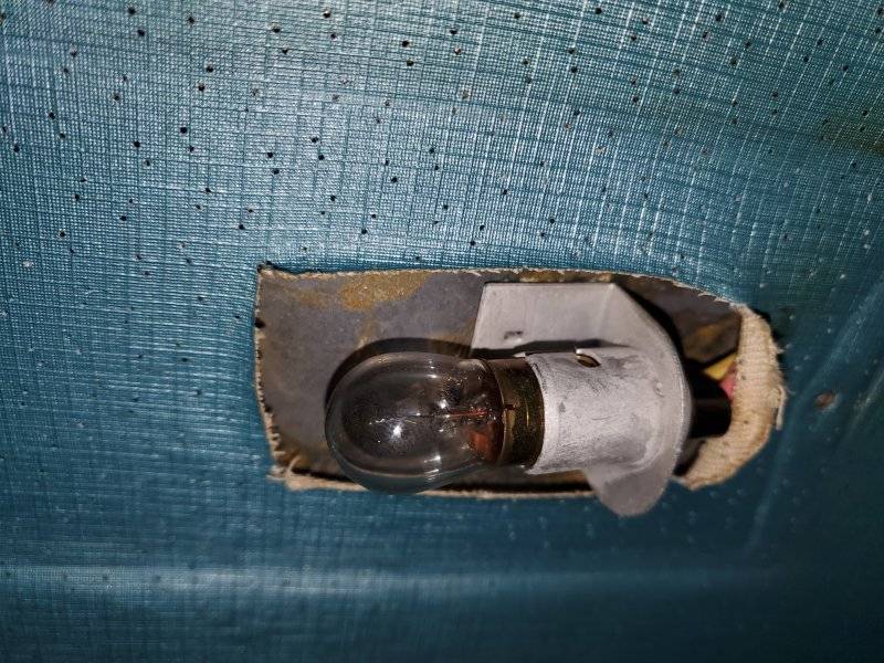

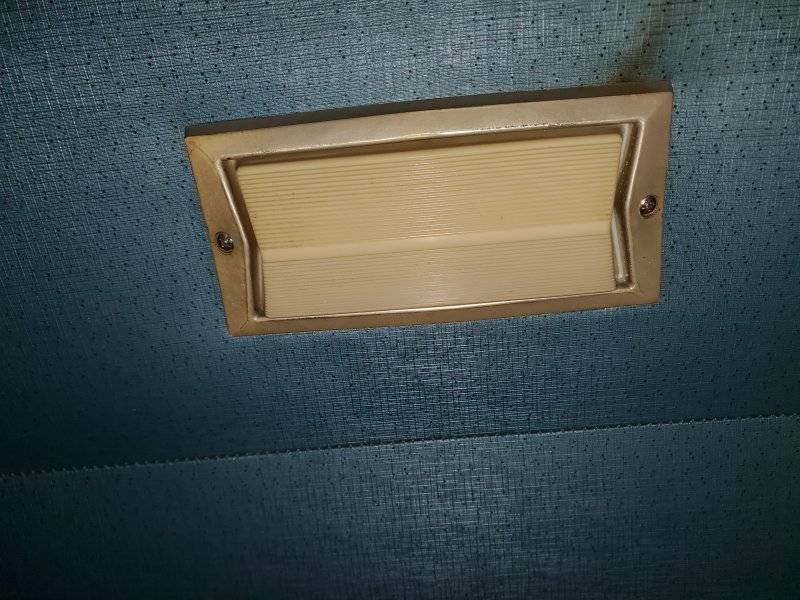

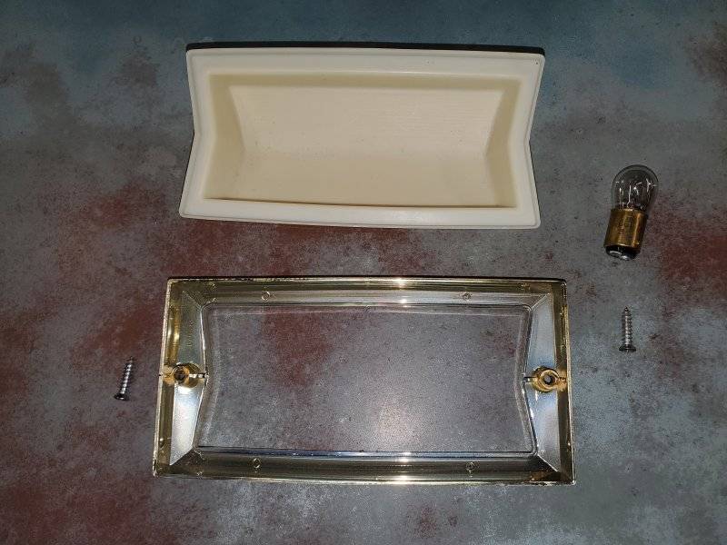

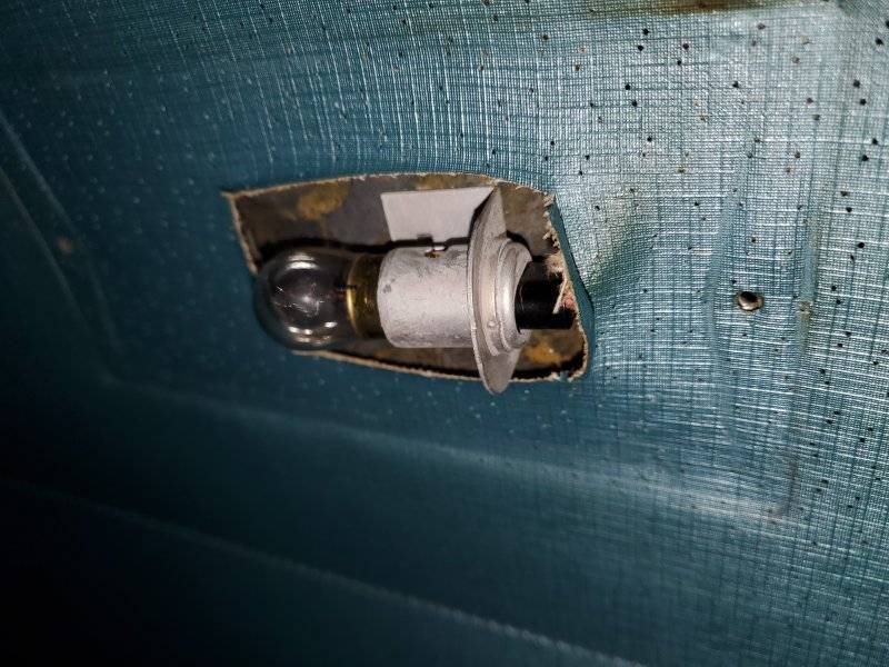

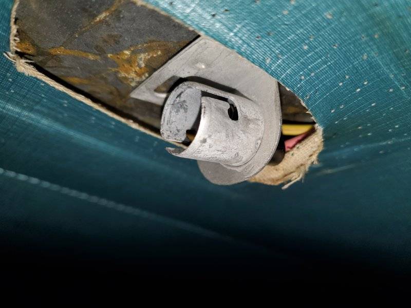

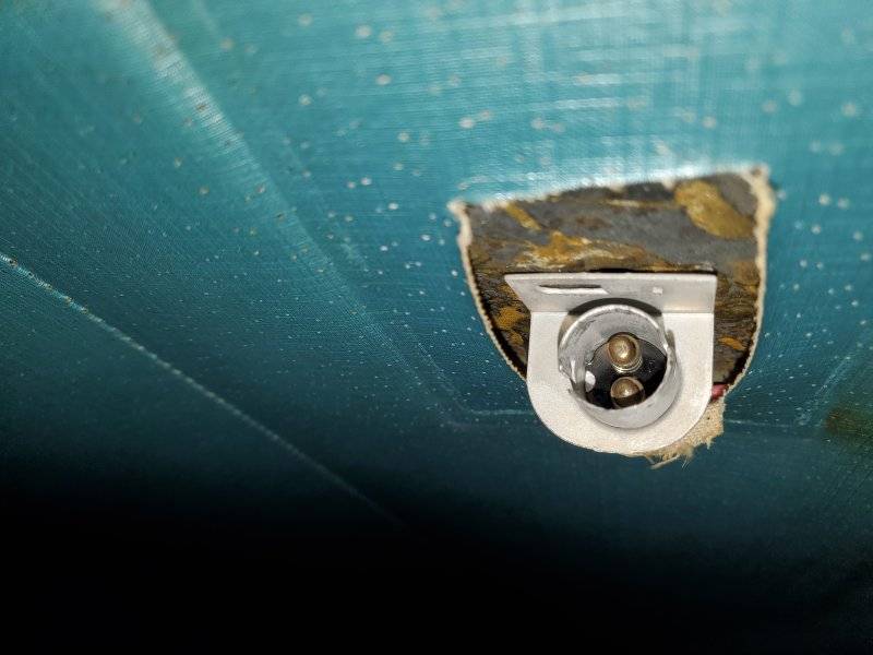

Sorry 65, I got caught up in life here, so I just grabbed these pics for you. No part #'s on them...
VANDAN, Just the photos I needed. Thank You !!

I may have a photo of the entire bracket, without the headliner. I’ll need a few days to get that.
