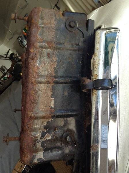

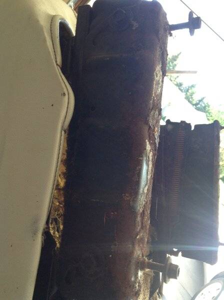

Hi Pizmo. I can help a little. You may be able to find aftermarket seat rails and then make some bracket to fit. I found a couple pics of the seat brackets to give you a little idea of what they look like.
