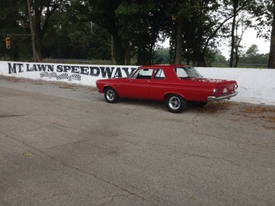

im running 275/60 r15 wheel vintiques oem Chrysler 63 series rims with 4.5 back spacing on my 65 belvedere II and had some scrapping issues on stock springs super stock springs fixed that issue thou and everything is all clear

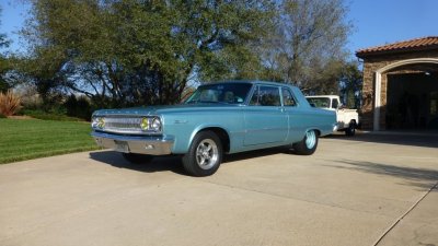

I've got 15x8 Cragar GTs with 275R60/15s on the back of my '65 Coronet 440 with no problems at all. Wheels have 4.5" back spacing.

Thanks 2LGT2QT Nice Coronet exact car and wheel combo I'm working on for this combo.
You shouldn't need the SS springs, I mentioned it because my car sits a little higher than stock.
Thanks for clarifying that PRND21 and Sweet car I love the way it sits. What did you do with you springs to get that height re-arch them?

Thanks for the compliment. Belvedere has 3800 lb super stock springs with about 30 psi in the air shocks. I adjusted the torsion bars until it looked right. I never really cared for the low rider look, although I've nothing against it, just personal preference. And really didn't need the air shocks, except that with 4 people in the car I'd get a slight right rear tire rub.
