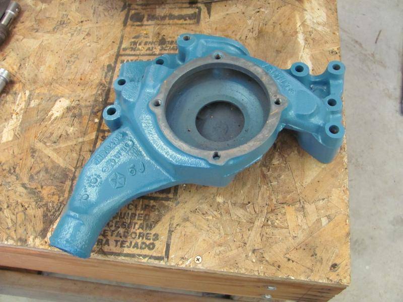

You could get a water pump housing from a later big block that moves the inlet to the passenger side. Then you would have to move radiator inlet to match.
PASSENGER SIDE !
