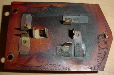

I'm trying to get the heat-A/C system in my 65 coronet to work right. Everything under the hood is OK but there are issues inside the car. I have no function on the med or high position of the blower, which are the positions that activate the Compressor. The resistor looks a little rough but seems to check out. Not sure about the switch.
The blower works on low and if I hotwire the resistor the compressor clicks on and blower speeds up, (both med and high position). All the vacuum positions are working fine.....
So far I have not been able to locate a replacement resistor or switch.
Does anyone have knowledge of this system....?
Thanks, Will.

I think your resistor is burned into, take it out and look. If not possibly switch,but i think resistor.

I'm pretty sure 64 and 65 are alike. It is mounted in the heater-A/C box at about left center. Mine has three mounting screws. There should be three connectors.... two three gang and one single.

Good news.... With the help of a ohm meter, test light and a jumper wire I was able to isolate the problem to the switch.
After bending the retainer tabs and disassembling the back part of the switch, cleaning and some adjustment everything works now.
