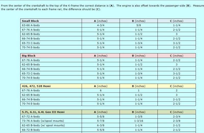

TTI had a stock motor position measurements on there website. I can't find it, only took a quick look. If you can't find them maybe call them?

As Fran mentioned TTI has a stock position chart and it shows that the Crank C/L should be 6" up from the Crossmember. Mine is 5" so I really don't want to lower the front anymore... Not to mention, I'm going back to my old Milodon 9qt pan, so clearance will be an issue.

TTI stock engine location chart.
Thanks Fran,
The motor is setting perfectly as per the TTI sheet. I have that very copy. Side to side is off set exactly 3" to the passenger side. The motor is setting about 5 1/8 off the k member. This is what has me so befuddled. LOL
