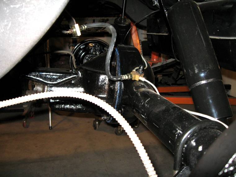

Can someone sent a picture of the connection of the rear-end brake hose to the body brake hard line. I took the car apart 3 1/2 years ago and of all the pictures I took I didn't have one of this connection. I thought I did a good job of ID-ing and bagging but I still find myself spending a great deal of time finding things. thanks ron
If the '65 is anything like like the '64, and I suspect it is... this is how it should look.
My 65 looks like the photo above.
I would caution you to check the required length of the flexible brake hose. When my suspension was fully extended, the "stock" hose was too short. I ended up using a longer hose from Russell.

Thank you all, after days of searching for the bracket, I finally found it while looking for another part. It don't pay to get old!
