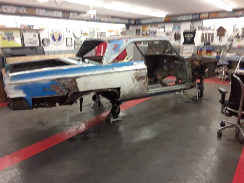

    Our next project is going to be a 65 Dodge Coronet 440 A/FX car. Hemi power with old school Hilborn fuel injection converted to electronic FI. Still work on final engine size but will be run on E-85 and be totally streetable with a stock looking A-990 single exhaust and RPM activated exhaust dumps. Target weight is 2800. Started with just a "tub". Just could not bring myself to cutting up a good car for this project. Got all the fiberglass A/FX body panels from Sled city. Here is what we are starting with. Much more to follow.

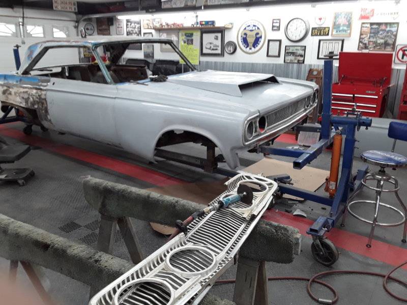

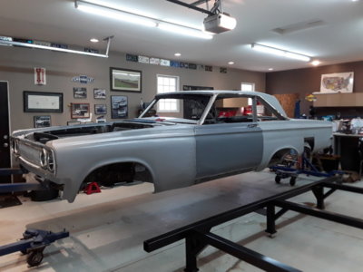

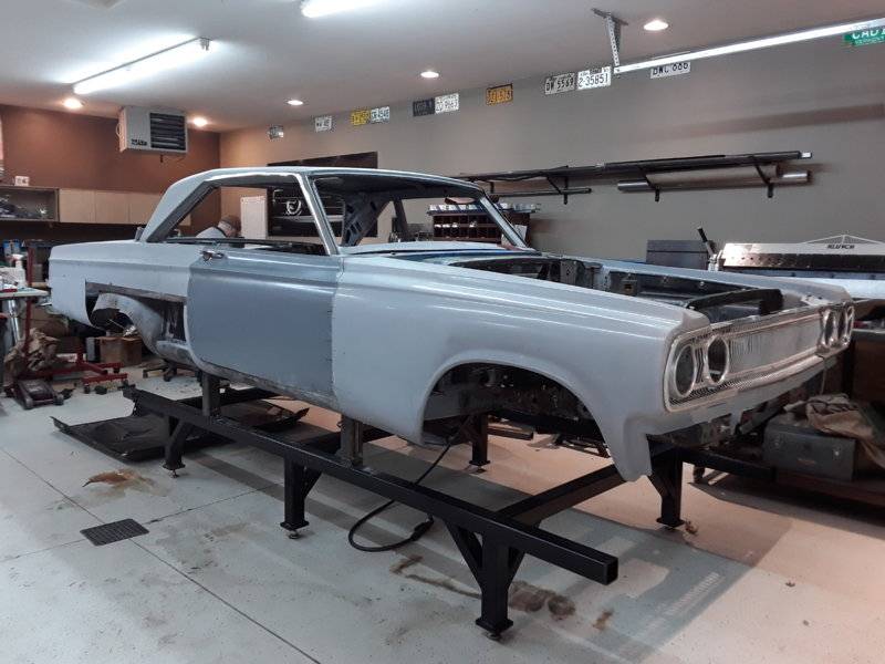

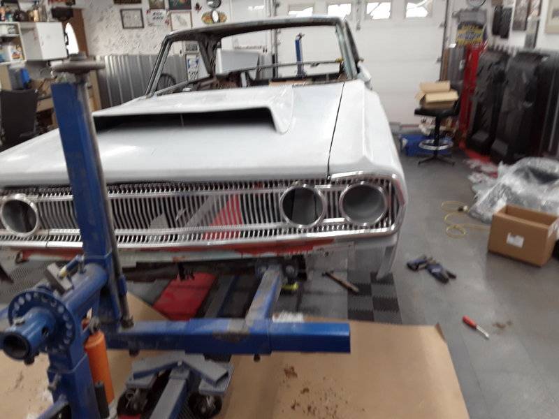

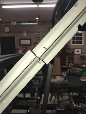

      test fitting the sled city fiberglass body panels.
      20180318_120722.jpg 20180318_120734.jpg 20180318_120740.jpg 20180318_120837.jpg

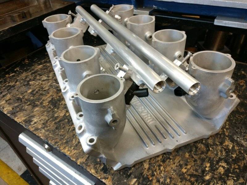

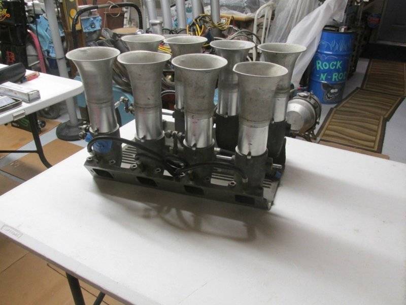

        Hiliborn FI unit
        • Like Like x 9

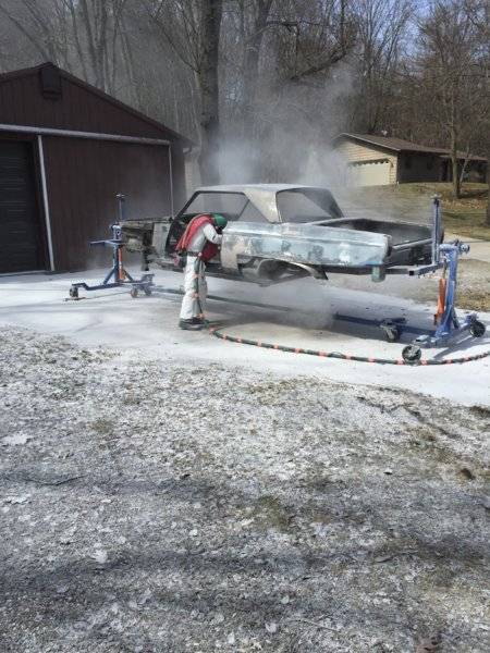

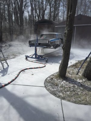

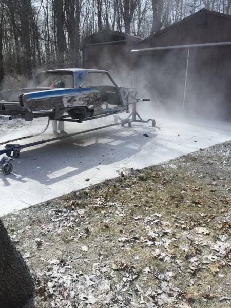

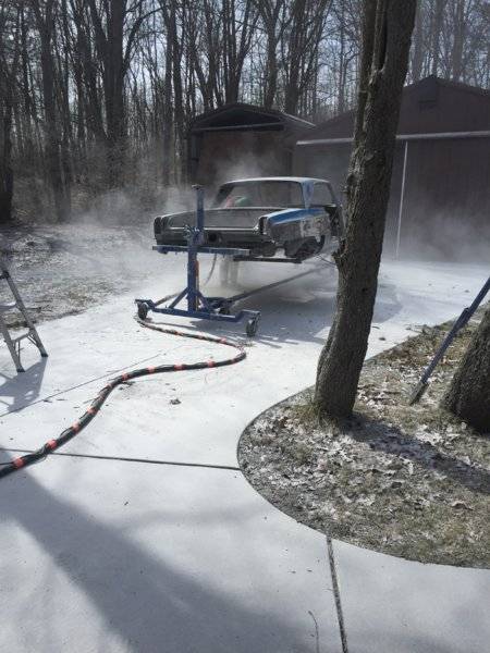

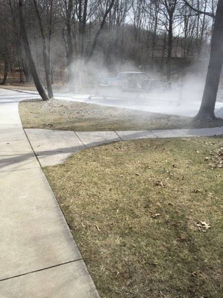

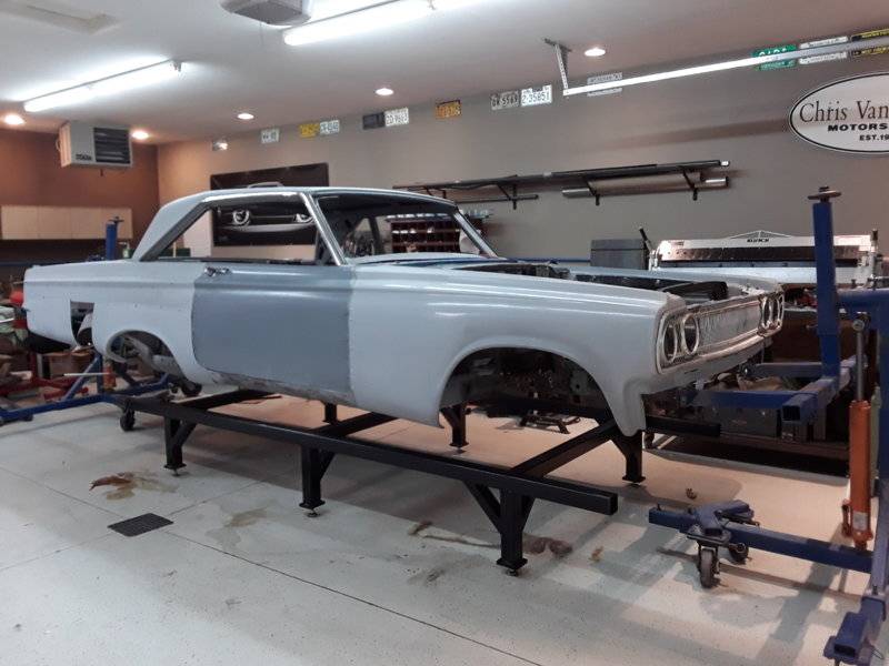

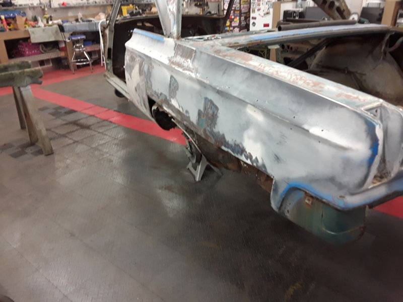

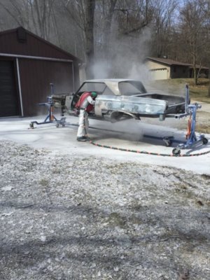

          Media blasting the body shell and getting voted by my neighbors best neighbor anyone could have.

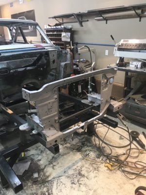

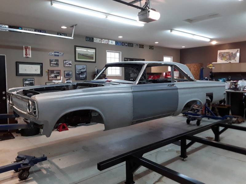

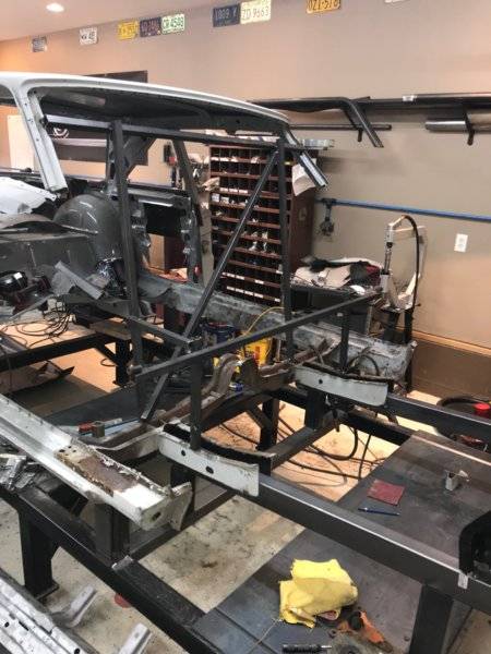

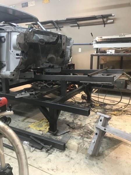

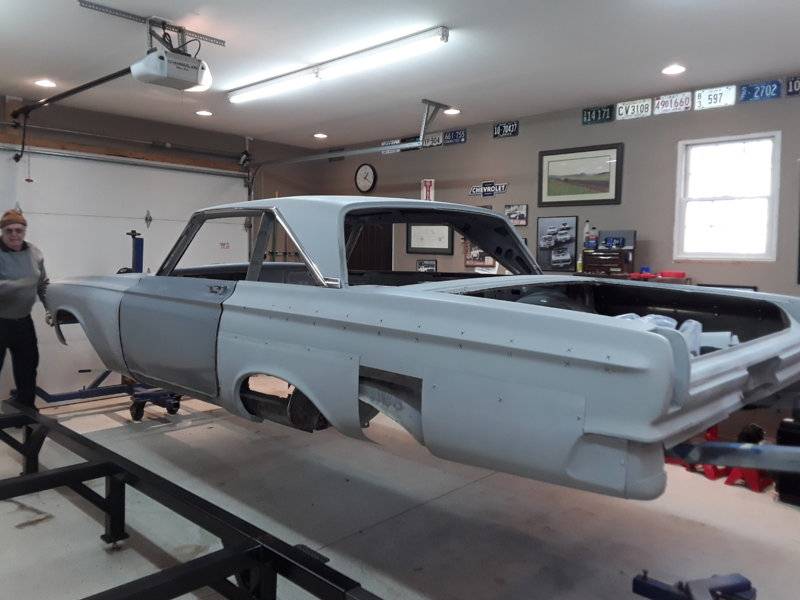

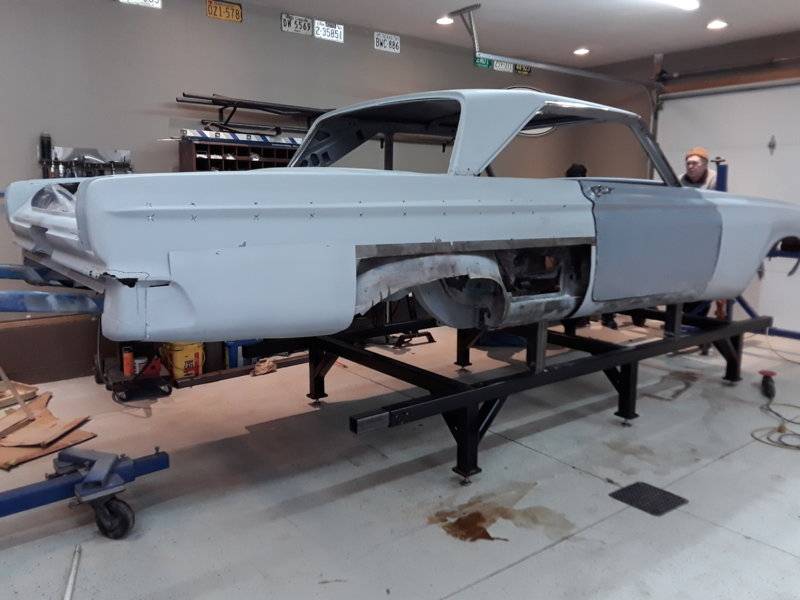

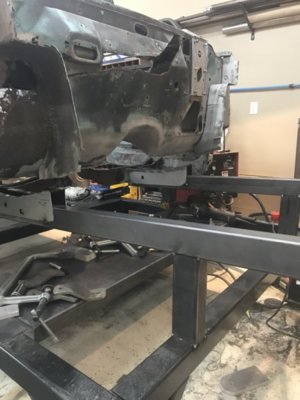

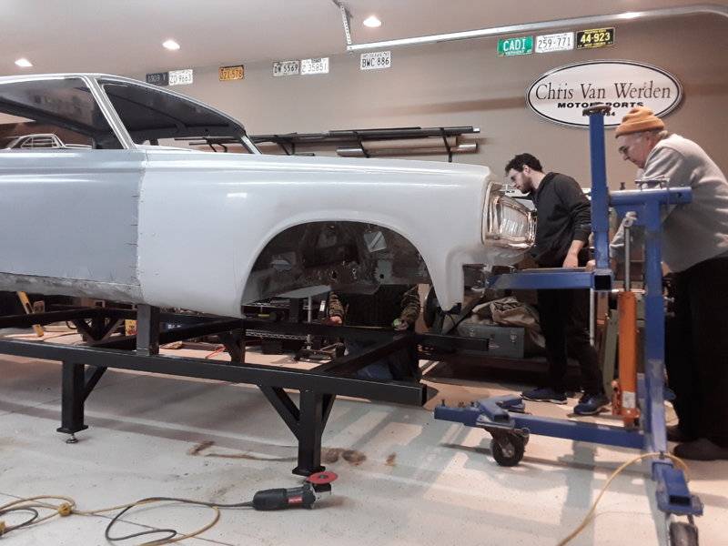

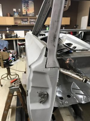

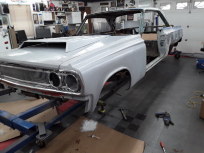

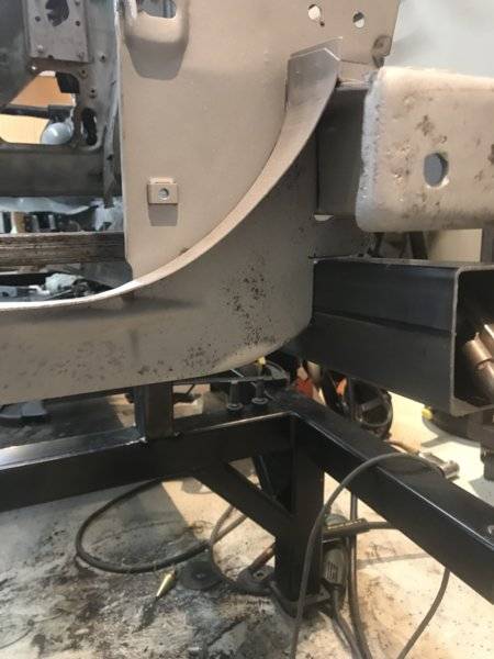

              Got the body mounted/leveled and welded to the chassis table. Laid out the new 2x3 front frame rails and got them tacked in place
              Image-1 (2).jpg Image-1 (3).jpg IMG-1844 (1).jpeg IMG-1845.jpeg IMG-1849 (1).jpeg IMG-1850 (1).jpeg IMG-1851 (1).jpeg IMG-1853 (1).jpeg

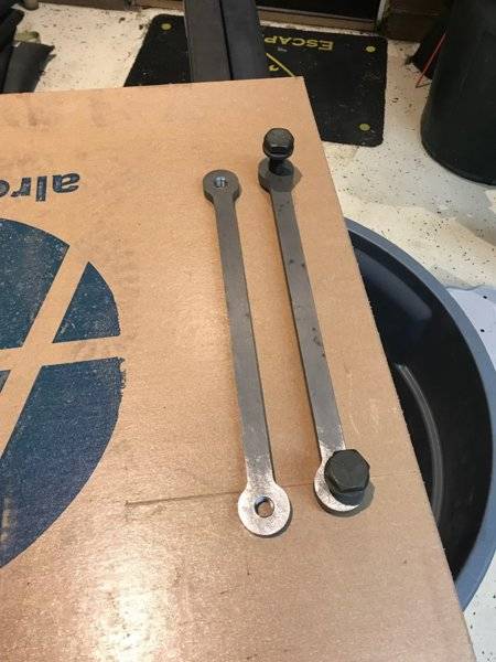

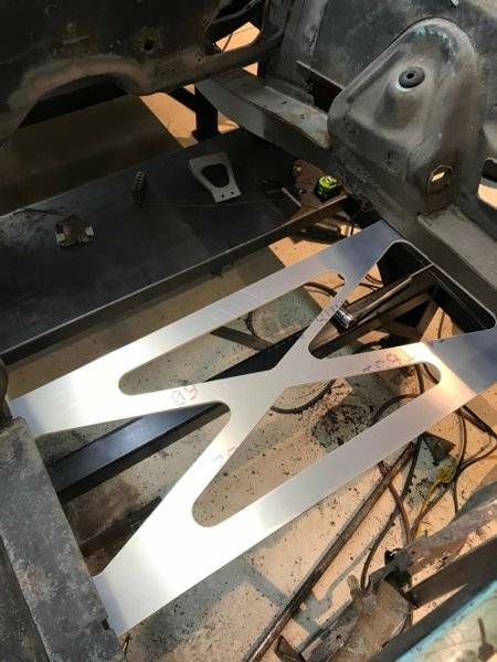

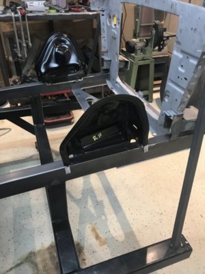

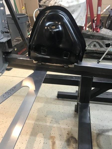

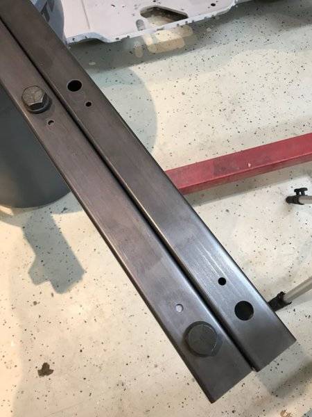

                          here is a neat little piece we made. It goes inside the 2x3 front frame rail and is welded in to bolt the K frame to
                          49292691_133106320965198_6898400836737564672_n[1].jpg 49503008_2168695570060626_2027469419797544960_n[1].jpg

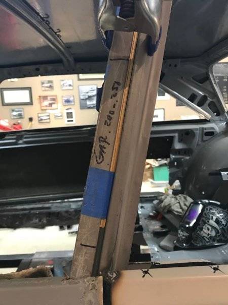

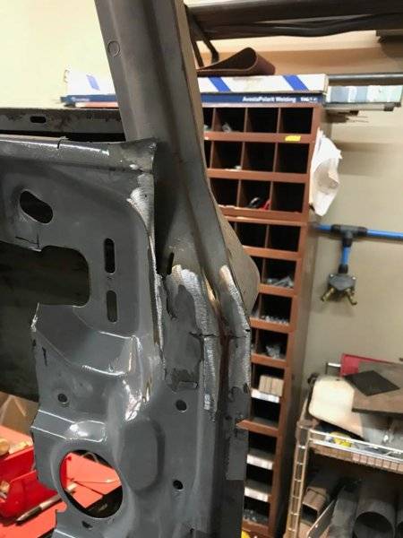

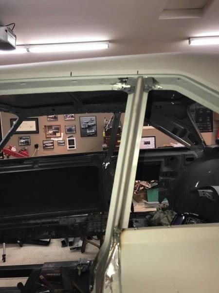

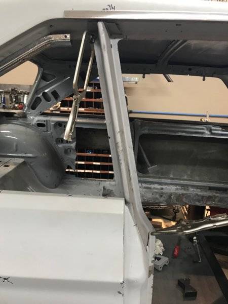

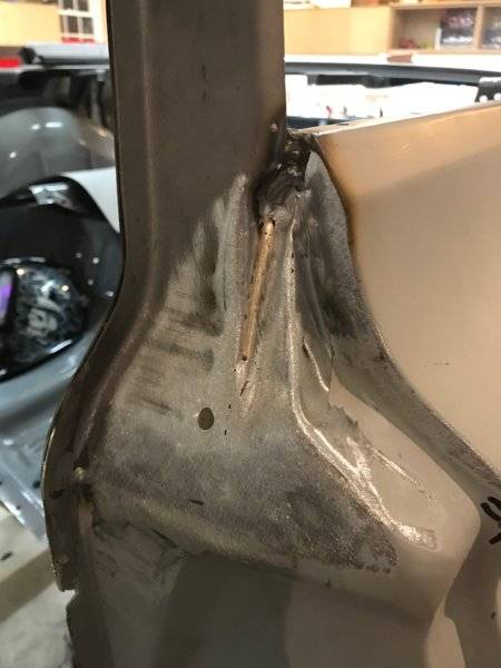

                              got the door posts welded in for the door window frames
                              51519909_726353547764762_6999394420017594368_n (1).jpg 51685637_436495613759230_4146481265735892992_n (2).jpg 52113254_2236819109694791_3078066326464364544_n[1].jpg 52585328_1076927655842356_140830976908460032_n[1].jpg 52602142_404356740139257_5841488159187140608_n[1].jpg 52991310_2025233411110346_2652891695468773376_n (1).jpg

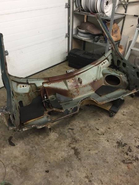

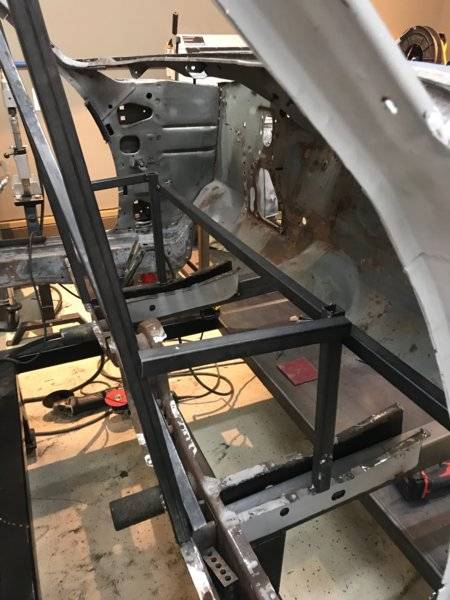

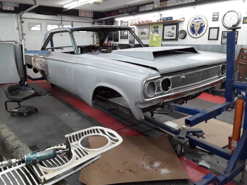

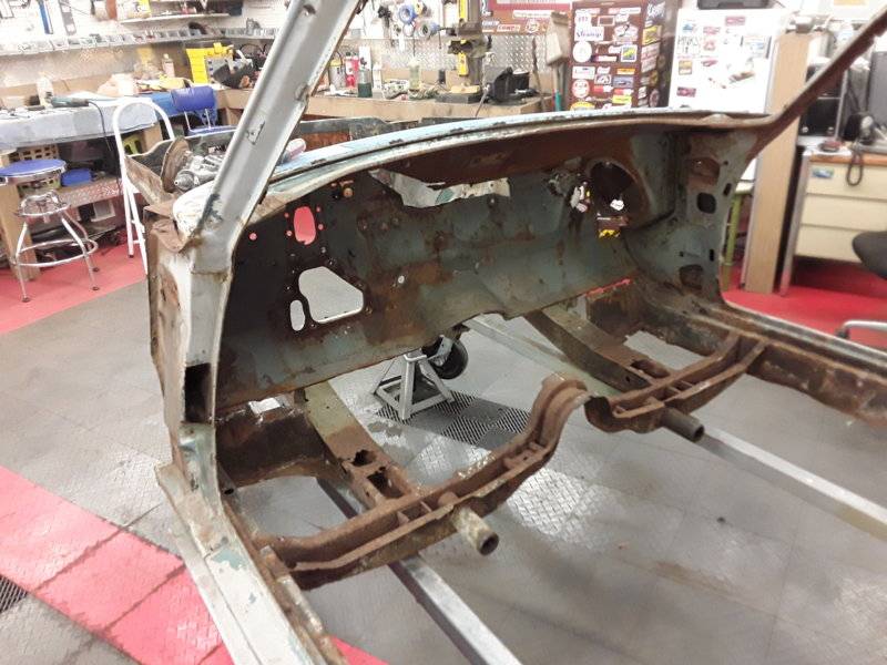

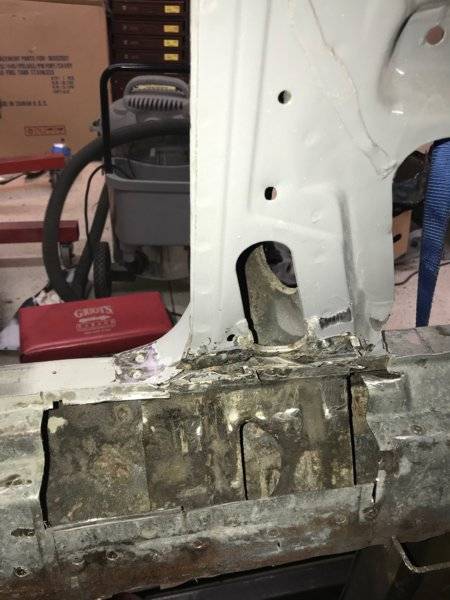

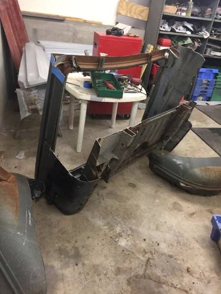

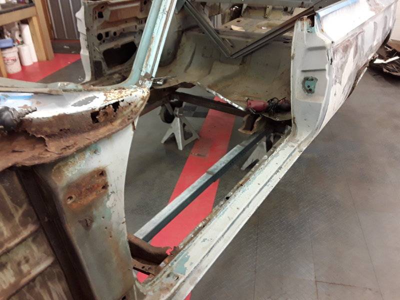

                                  Now decided to replace the firewall. The one in the car is a little to far gone and we found a real nice one to replace it. Also decided to replace the rockers with new ones. also going to replace the tail light panel So basically the only thing that will be left of the original body is the roof and the door jambs and about 1/3rd of the quarter panels
