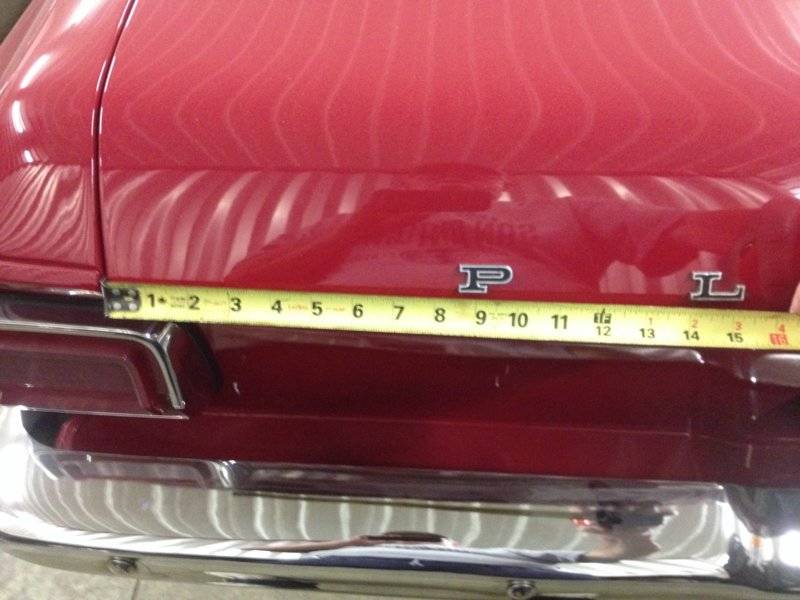

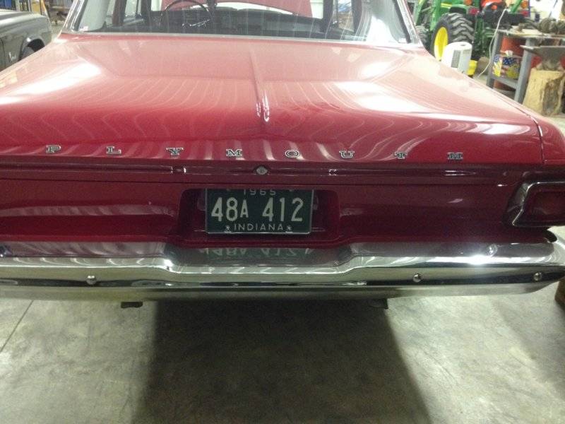

Pictures aren’t the best, but from the left edge of the trunk lid the P is centered on 9 1/8”, the rest at 14 5/8, 20 1/2, 26 1/4, 32, 43 3/16, 48 3/4. The P and the H are centered 1” above the crease, the rest are in a straight line. Hope that answers your question. This is on a Belvedere 1.
B326EF2E-B946-4DE9-927B-1763034ECEE7.jpeg 169371FF-BF51-4117-85CF-D7A773E66919.jpeg
View attachment 608890 View attachment 608891
that helps alot..thank you..gonna do this soon. previous owner took them off but I want them back on..
