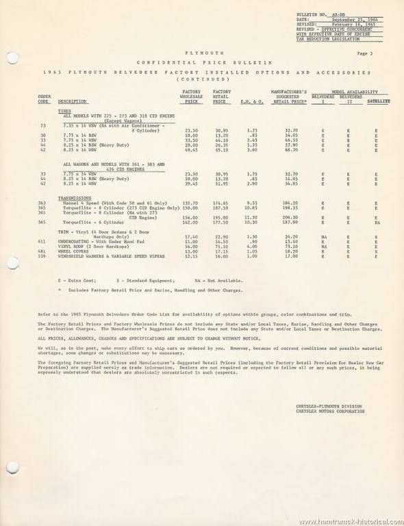

This is for a Belvedere but it should be the same for a Coronet.....
http://www.hamtramck-historical.com/images/dealerships/DealershipDataBook/1965/65_Coronet0001.jpg

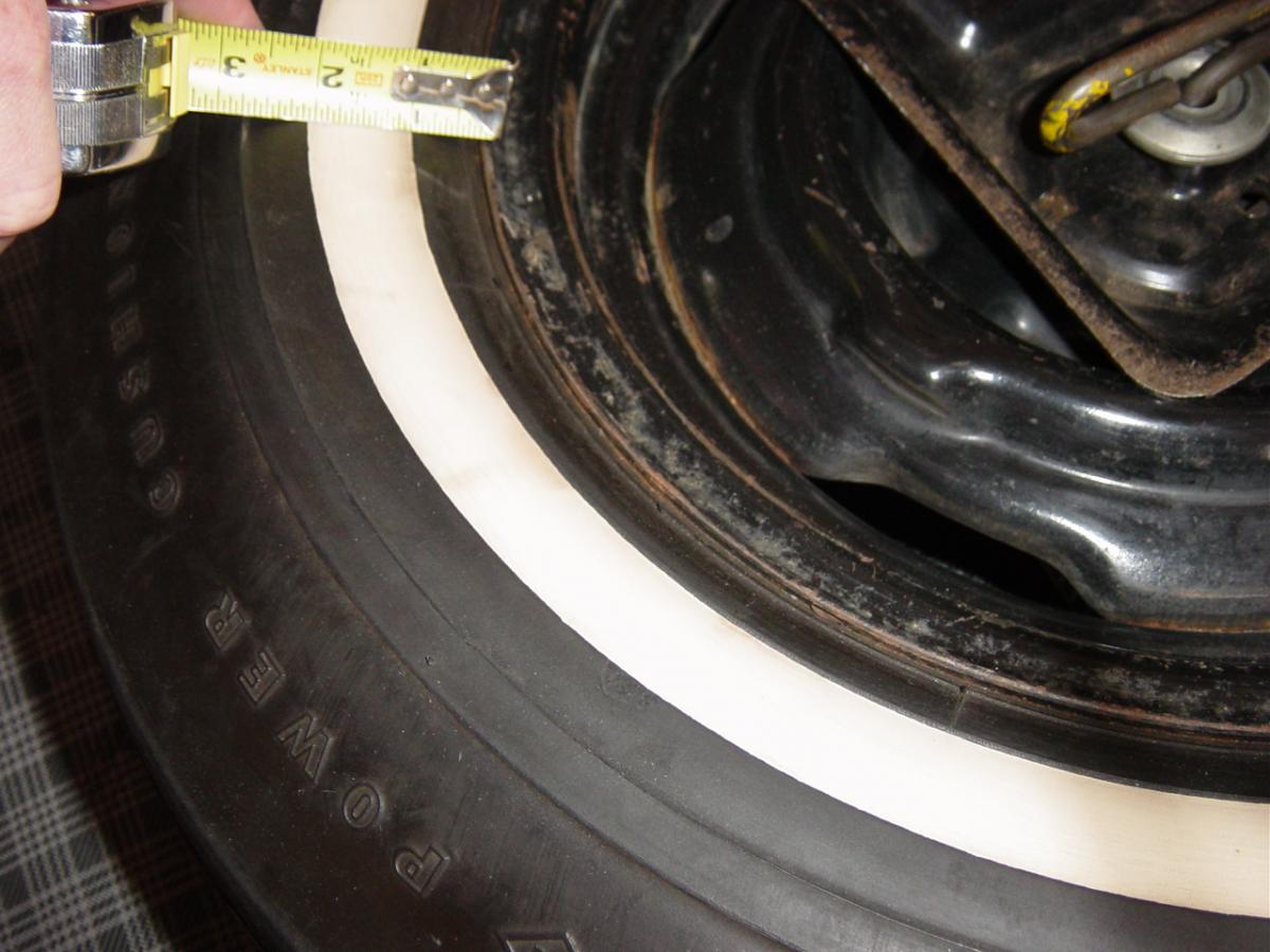

Here's a shot of the original spare tire in my 65 Belvedere II convertible that came with Goodyear Power Cushion 7.75 x 14 whitewalls (1 1/16"). This has been with the car since November 1964 but I don't know about other makes of tires.
Arland
