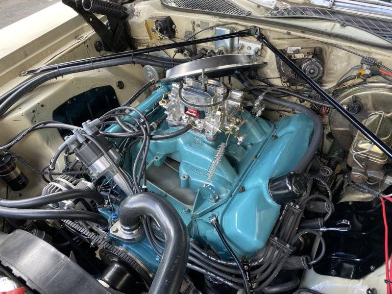

New 650 AVS 2 on my mild 440 cui in my 73 coronet station wagon runs out of the box nearly perfect in all conditions, only if I kick the pedal to the metal as quick as I can I get a lag about a half Second because it’s goes lean to 20 AFR for a 1/4 Second .
Any suggestion to fix it?
Accelerator pump linkage i put already from middle to top hole . Nozzle is stock setting 31 . I not sure makes sense to Try a 35 nozzle Because the lag is so short and only if I kick him very quick . Maybe have to live with it ?
More accelerator pump is the only thing I can think of too. Since you have AFR data, open it it and see what happens.

Move the accelerator pump rod to the hole closest to the air horn. I've fixed a few this way.

This I had done first after the first drives out of the box , because stock was middle hole , I put already in top hole . But thanks
@all I switch it now from 31 to 35 pump nozzle , and after the first test drive 5 minutes ago it’s feels and show on A/F display much better . I on the right way I think . Now o think you guys right , it’s seems if I quick accelerate only in first 1/4 1/2 of Pedal way all fine, only if I put the pedal quick like pedal to the Metal ( secondary’s Open - air door too ) , it ‚s still have a very short lag ( half sec. Or less ) and shows me on AFR short it’s lean full out . Now I try to get the secondary air door spring half turn stiffer and try again!

You use to much of the transition slot. How much initial timing do you run?
You have and use a vacuum can on your distributor?

Thanks , exactly this what you say I was consider ,that’s mean I have to less timing in idle ? And my idle set screws is to far inside , right ?
Timming in idle unter 10 actually , but I try many timming curves already .... also with the stiffest black springs ...
only what I really wonder on this distributer is the different Plastic keys for set the degree of advance , the keys start with 14 degree and end with 28 degree . But if I adjust the slot with the 14 degree key, they advance curve ist about 20-22 degree ... that’s I really wonder .

Crank that secondary air spring about 1/2 turn tighter, then try it.
