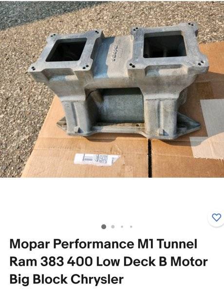

Just as well add one of these and shoot for 700hp. Our popular NSS class here requires 2 or 3 carbs. :thumbsup: We are installing a Weiand tunnel ram on ours. This M1 is on ebay.
