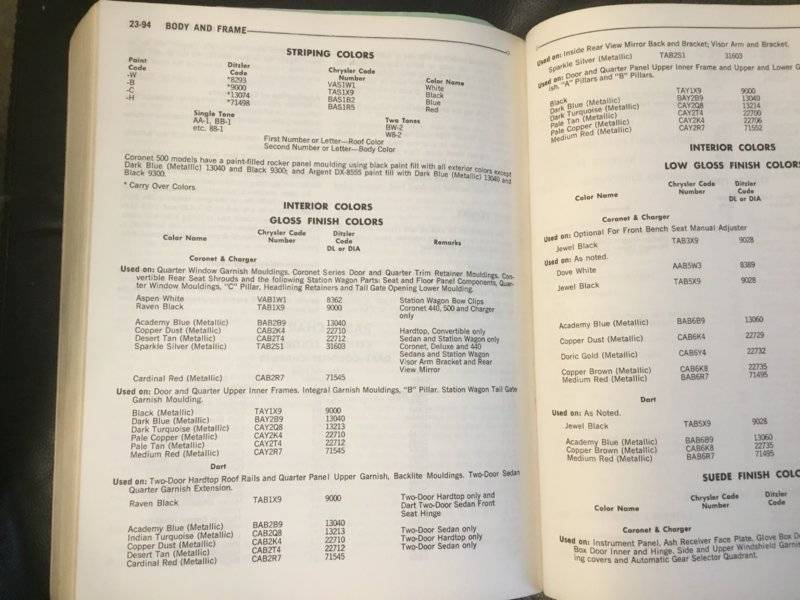

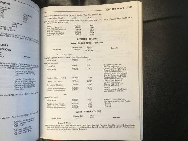

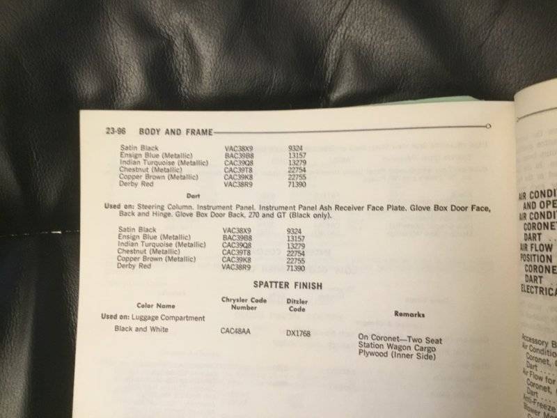

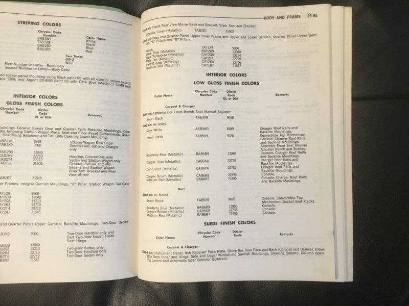

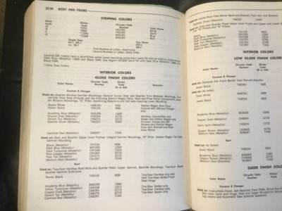

Working on the 1967 440 4sp Charger.
I am trying to get things correct, and will try to send pictures from the FSM. There are 3 different blacks used.
Gloss. Raven black. TAB1X9. 8362
Low Gloss Jewel black. TAB3X9. 9028
Suede Finish Satin blackVac38X9 9324
Some time ago, I picked up Herb`s Interior black while down South. They didn’t say anything about purchasing a prep. I sent them an email a little while ago, asking what I could use but didn’t get a reply. Not sure what I can use. I prepped a console with SEM. Seemed to work, but not as shiny as a original console. Wondering what some others have done.
I am thinking of doing the whole metal dash also and want that as close to original as I can. Back in 1996 I did all the plastic and vinyl with SEM, looked great!
I am not going to clean the ABS with acetone, because I can make glue with those two mixed together . Thanks for any input/suggestions

I’m guessing a little bit but your three colors are probably like this:
gloss - anything that’s painted like door frames, not dash.
low gloss - probably for plastics and vinyl colors, upholstery.
suede - dash frame. I have a local PPG jobber that developed a base coat formula for the suede finish at $20 for 1/2 pint. If you can find lacquer it’ll be $200 a 1/2 pint or pint.
Herbs would probably be your low gloss.
