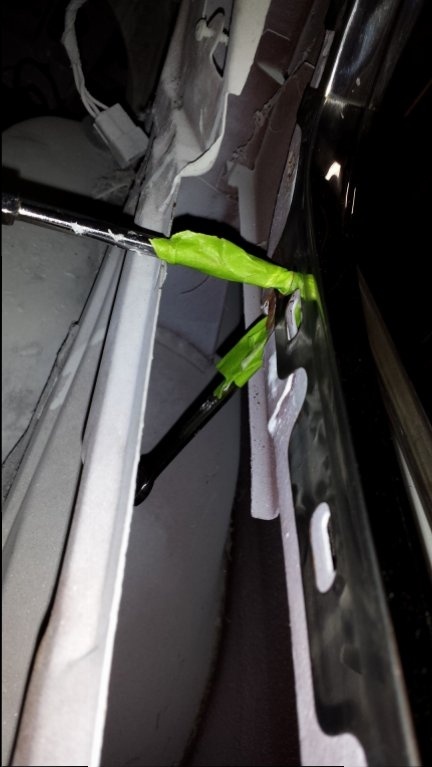

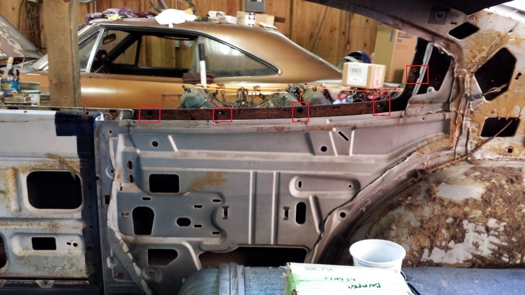

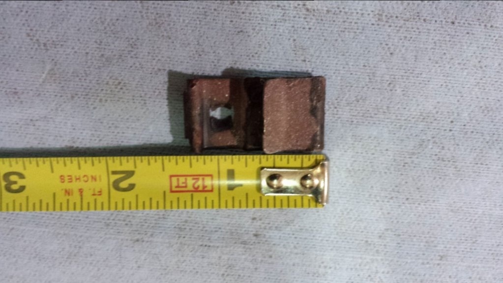

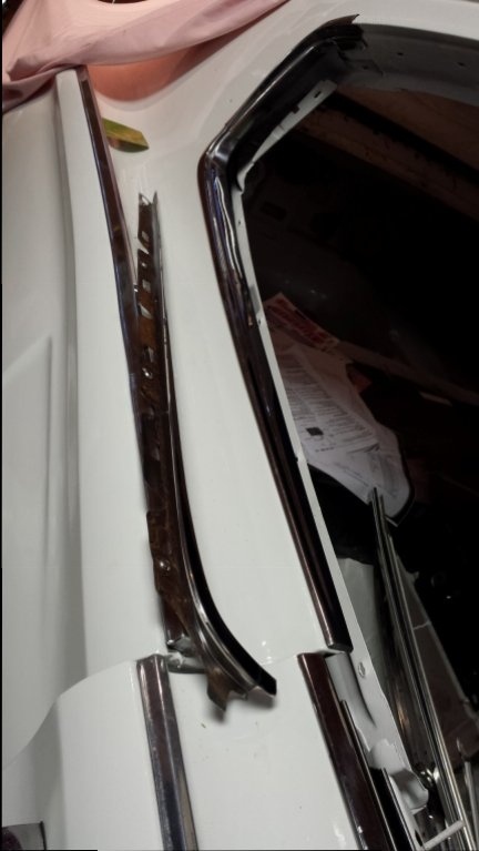

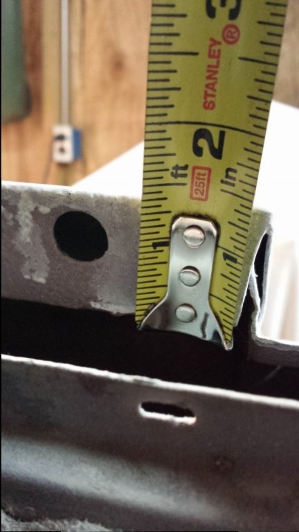

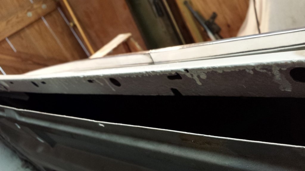

The problem is the length or "throat".
They are the speed nuts, clip nuts, j-nuts, tinnerman nuts, spring clips, etc. etc, etc.
The originals used like a number 6 flat head screws to be flush with the stainless trim there.
I've been looking on line for a while now.
All short stuff.
I could use some thing else like fender washers and plain nuts with machine screws.
But it is sort of hard to get too.
Any sources?

I'm not seeing anything that might work work and I'm figuring I will have to improvise someway.
LIke this!
https://www.forbbodiesonly.com/mopa...n-and-an-alternative-attaching-method.120788/
https://www.clipsandfasteners.com/Nuts_U_s/115.htm
http://stores.restorationspecialties.com/speed-nuts-u-j-machine-thread/

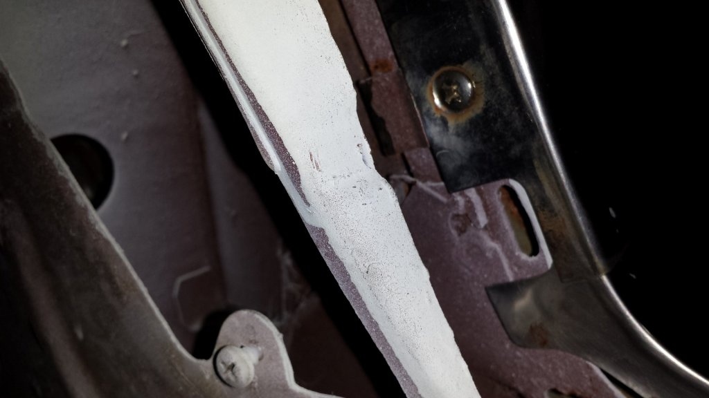

One of the problems is how close that number 6 screw hole is to the top of the clip.
And I'm thinking that is the screw is bigger than a number 6 the flat head screw won't be flush with the chrome trim.
The car body hole they go in is big and far from the metal edge.
I got frustrated last weekend trying to use a machine screw and a nut and figured I would try something else.
LIke this!

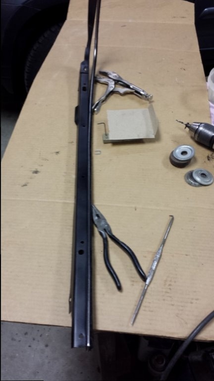

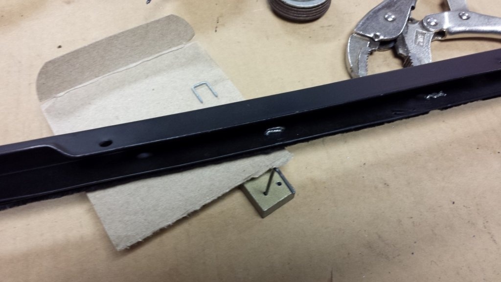

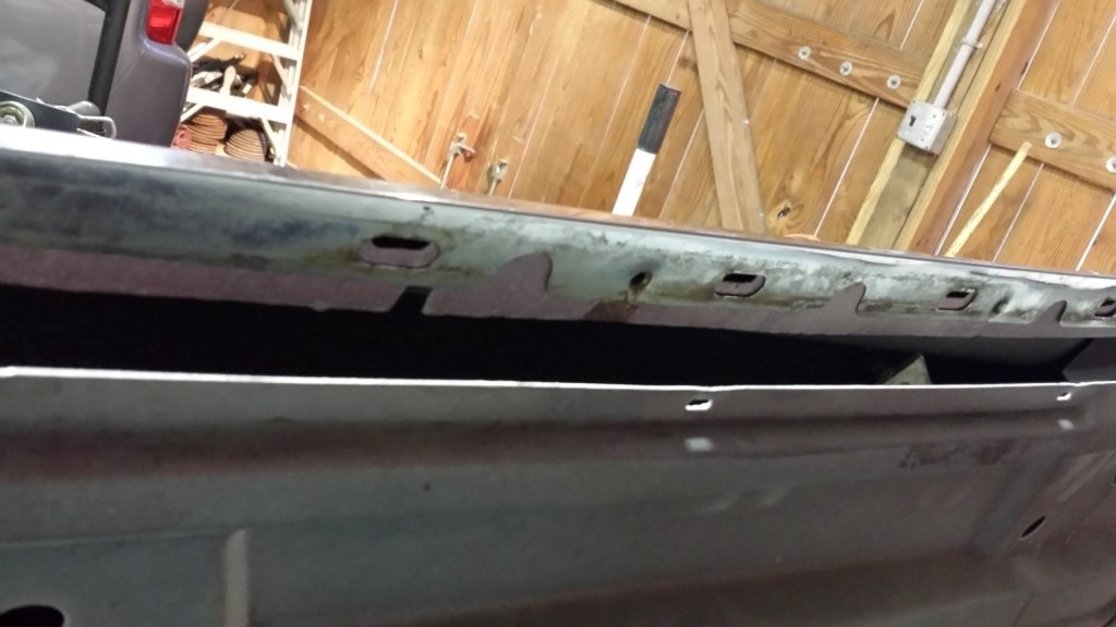

I don't think the fasteners exist.
I posted out of desperation and to give others a hint of this.
I used stainless fender washers, machine screws and nuts with a little polyurethane for keeping the nuts from shaking off.
Yea, I could have used lock nuts. But less fighting in the tight area.
I was able to save one or two of the tinnerman and reuse them in the upright area.
That would have been impossible to get behind it.
And then there is the fuzzy.
Chrysler must have had a machine to put the staples in.
What a PITA!.
