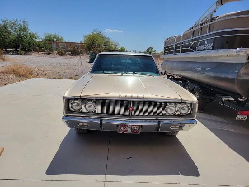

Hi is the 66 67 grills interchangerable and are the fenders the same what about charger grill . Thanks in advance .
The grills are different, but I can't say if they are interchangeble.. Fenders are the same, but the headlight buckets are welded in one and attached in the other.. I cant remember which.....
Turn signals in the 66 grill, in the bumper in the 67.
I have seen charger grills in Coronets, but not sure what it takes to do it..
I the 67 Coronet is exclusive to the Coronet its self and the 66 is different..
its harder to find nice 67 Coronet grill surrounds.
The headlight spacing is different from 66 to 67 Coronet. Making it real hard to swap grilles.
The 66 Coronet has welded in headlight bucket mountings. 67 Coronet and 66-67 Charger are bolt in headlight bucket mountings.
67 Coronet is the only front bumper with turn signal and park lights in it.

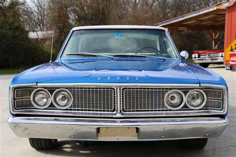

compare the hood fender gap to the headlight placement in this pic 66 and the one below 67.
