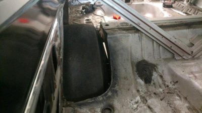

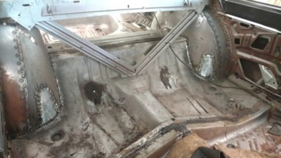

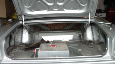

Did a full back-half, 4-link, and legal S/S moly cage in my WO. My 66 Belvedere is very similar. What exactly, do you want to see? I'll post later....I'm leaving to go pew-pew-pew-pew.
For the most part ideas of what was done things other may do different if they could plus pics of the finished product and the stance of the car is very important.
Just got back from shooting......
Most of these setups are pretty similar. People design different bar configurations, round or 2X3 for rear frame, and normally 9" Ford or Dana rears. Ladder-bar or 4-link would depend on the usage and amount of time and skills at chassis adjustment. ET will determine how much chassis you need to race at sanctioned tracks. Different shocks, diagonal or wish-bone bar, anti-roll bar, driveshaft loops, and the amount of original floors all come into play. Before you get too serious, I'd go to a mopar race, and look at what you like about certain people's cars....and ask questions to the car owners. It's easy to get carried-away.

Belvedere is similar. Has more interior bars, and more time and attention to using more of the original car. The 4-bar is different, and it'll still accept leaf-springs and a wider rear axle....if someone wanted. Tubs and tires are bigger/taller on the Coronet setup.

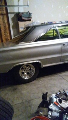

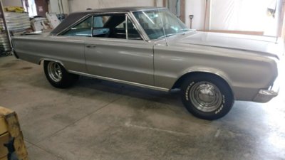

Which car? Current wheel/tire combo on the WO.... 14X32 M/T on 15X13" Cragar Super-Tricks, and M/T 29.5" fronts on 15X3.5" Cragar Super-Tricks.

5 1/2 or 6"., if I remember correctly. My mind isn't doing math right now...LOL I know the Bogarts were 15X10 with a 3 1/2" BS. But, I think the Tricks could go out another inch and look more inboard than the Bogarts were. I threw the bare tricks in the wheel-houses, and saw they'd fit. I know I also measured the width at 13".
