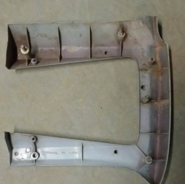

My 66 coronet pass side housing is cracked and I'm looking for a good one.
snook

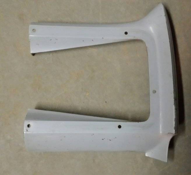

I have this one if you néed it.
There is a piece of trim that fits in there. The extension I have is staight with no tears. Let me know if it works for.you.
I don't use any trim there but I guess I can just fill the holes. It will work for me, PM me with a price - I live in Port St. Lucie FL 34983
Thanks, snook

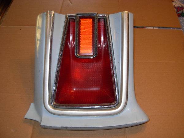

IIRC, they are different.....and the one above looks correct for the 66.
I will check on shipping and get back to you tomorrow
67 fastens from the inside of the trunk lid to stud towers off of the rear of the center panel, and the lights and housing from the inside as well. 66 has the trim that fastens along the outside edge as does the Charger.
and the 1967 which fits into the well of the extension and the studs poke through the floor of the well into the trunk area.

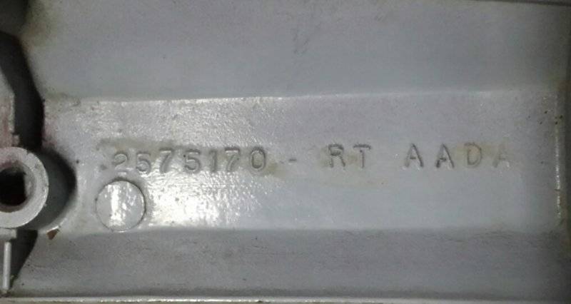

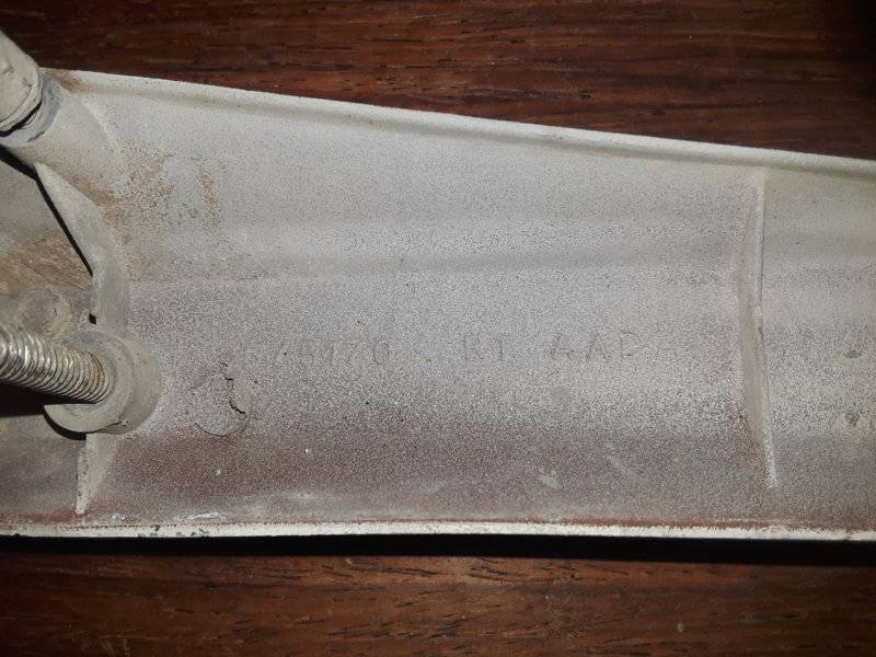

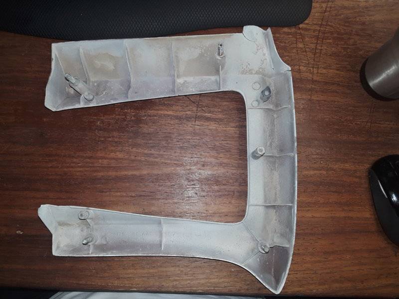

That's the same part number as mine but It never had those holes. I attached some pics. Same with the LH side extension too.
snook
My car is a WE21 car - plain as it can be.
