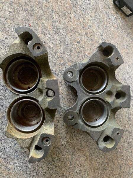

There's no big trick to fixturing because the bores are perpendicular to the bolting faces. Anyone have
a caliper that's trashed laying around so I could look at some close pics?

I have a set on my bench that are cleaned up & ready to assemble...
