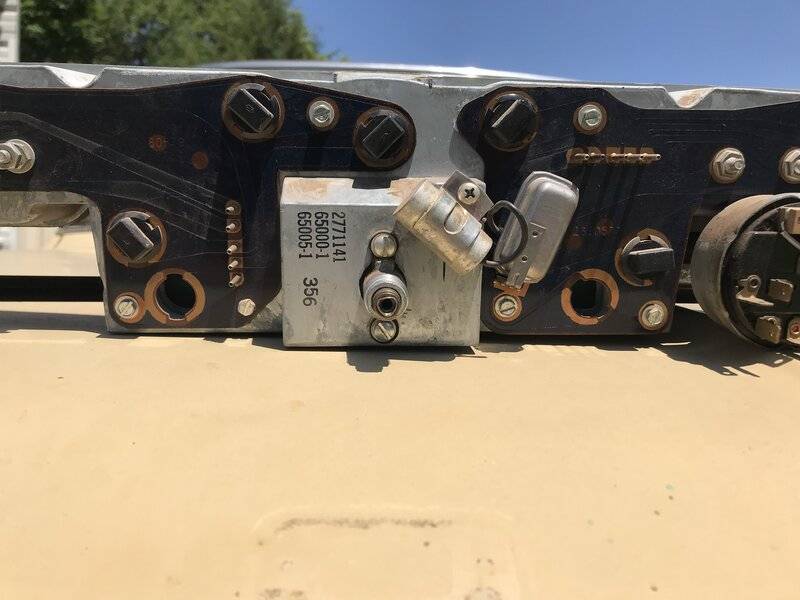

On my 66 Satellite the only thing not functioning is the turn signal lights in the dash.
Does anyone have a dash cluster handy that you can show the backside and where they are? When I let my fingers do the walking I keep pulling an illumination bulb in the general area I think I should be in.

That are set up to not work on a Satellite. The factory put black tape over the holes for the sockets in the dash. That’s why you can’t find the bulbs, there aren’t any!
Only the fender indicators function. Strange but true.

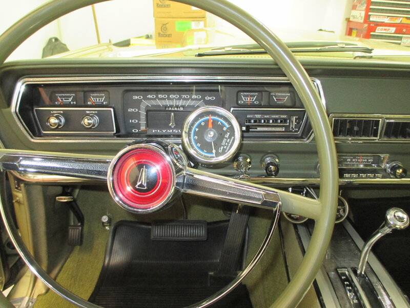

The empty holes along the bottom are where the turn signal indicator lights would go.

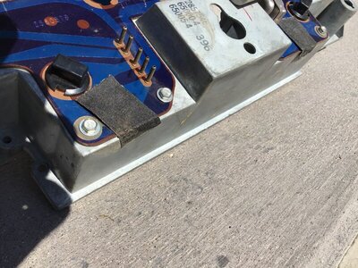

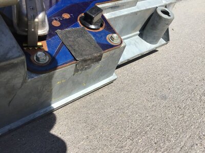

The next two are photos of the black tape over the holes. This is how the factory did it.
It’s very puzzling when you take out the cluster and it has old hardened dried black tape over the holes for the bulbs. And when you remove the tape you can plainly see there was never a bulb in those positions.
Now I’d bet that many cars got the bulbs from the factory. And how many folks brought their car back to the dealership and complained about them not working? Plenty?
