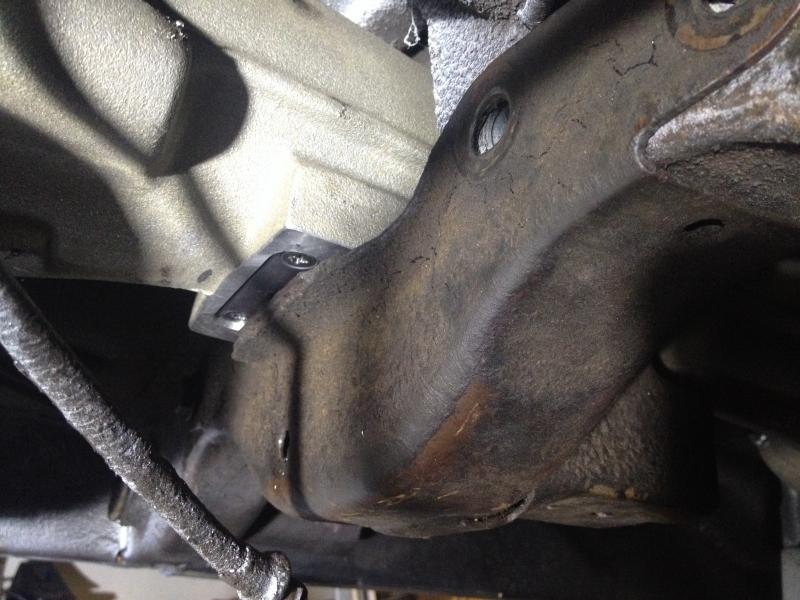

starting this thread again based on the info that i just learned...I'm starting by say that a trans mount must be modified when using the latter K~member with the latter trans;
I just installed a RMS alterkation suspension in my 65 Satellite with motor mounts located in the latter B~Bodie location and also using the latter transmission
"not the bush button style"
the biggest issue is the "trans mount bolts" its about 3 inches further back then the stock location also the 65 trans has a wider bolt mounting base than the latter trans im in the processes of trying other cross members and mounts...A~Bodie / latter B~Bodies / and a truck style mount, but deep down i feel modifying the original cross member will be the easiest way and best way and ill keep you guys posted...
also running a Gear Vendor but the location of the mount is in the stock location any input would be helpful

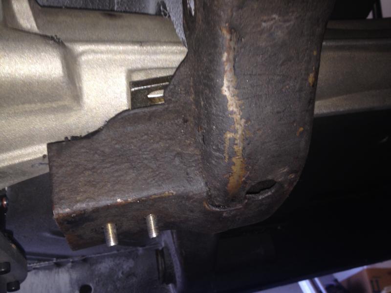

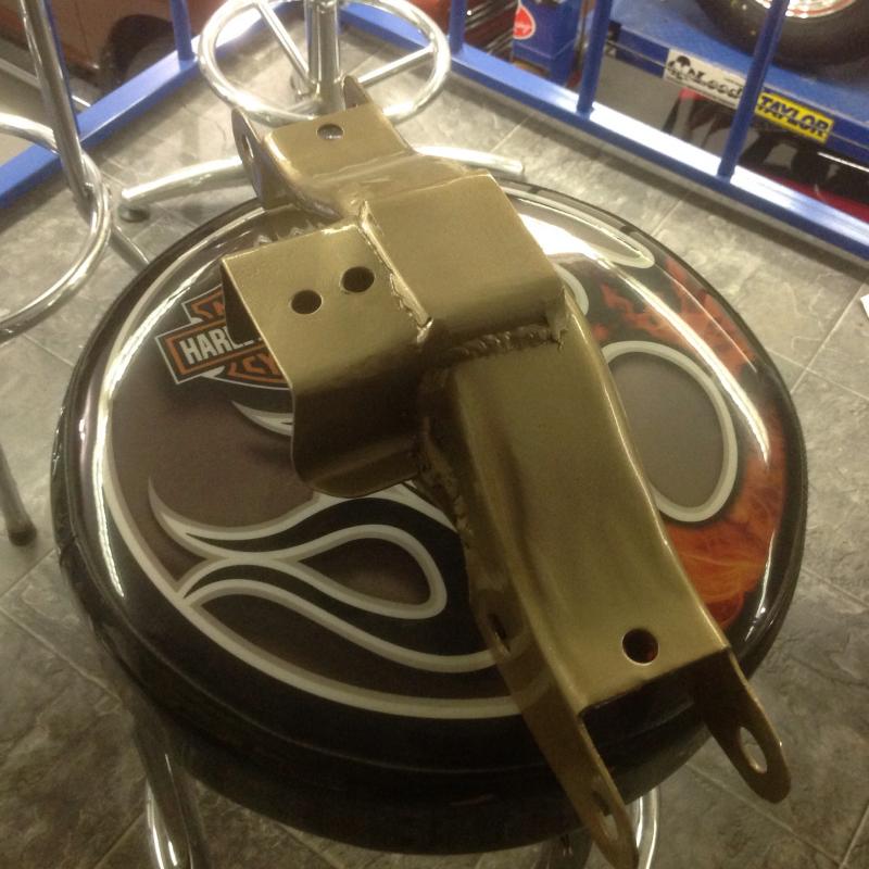

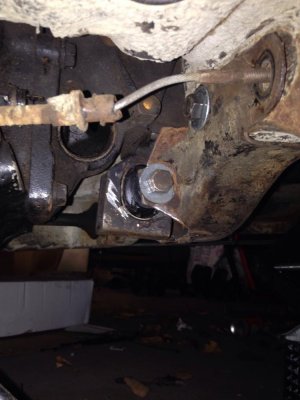

I have the newer K frame in my 64. This is my crossmember that I modified to work with the stock stye mount.image.jpg

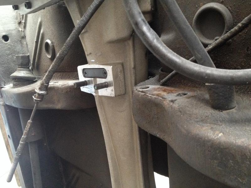

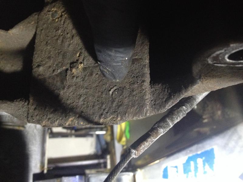

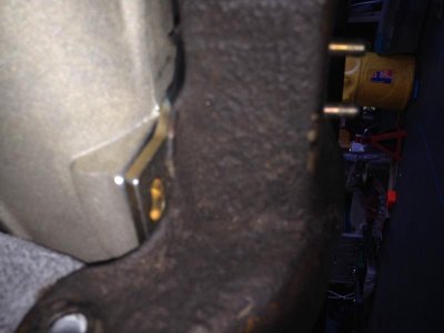

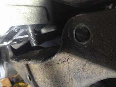

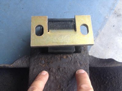

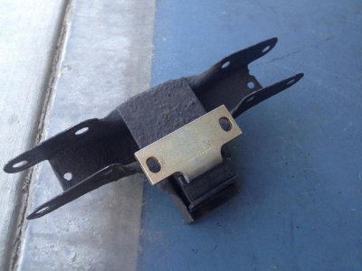

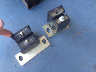

so this is what im up against...the bolt lines up with the side wall almost exactly, in the last pic you can see the impression from the bolt onto the cross-member.
in the second picture i pulled the studs out to install the cross-member plus i turned the cross-member 180 so that i could better see and understand whats going on
that looks great do you have any pics of the top !!
I have the newer K frame in my 64. This is my crossmember that I modified to work with the stock stye mount.View attachment 254491

I don't have the mount handy, sorry. The mount fits into the box'd area and the stud drops through. No other mods req'd on mine.image.jpgimage.jpg

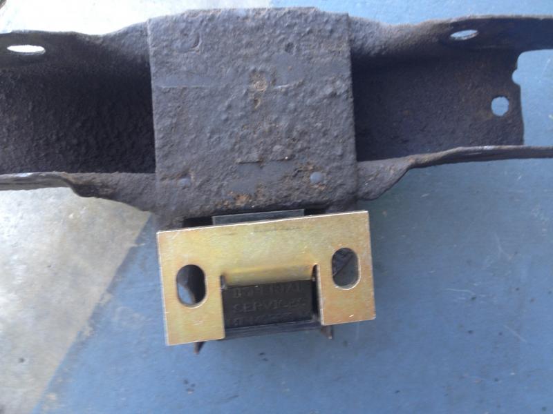

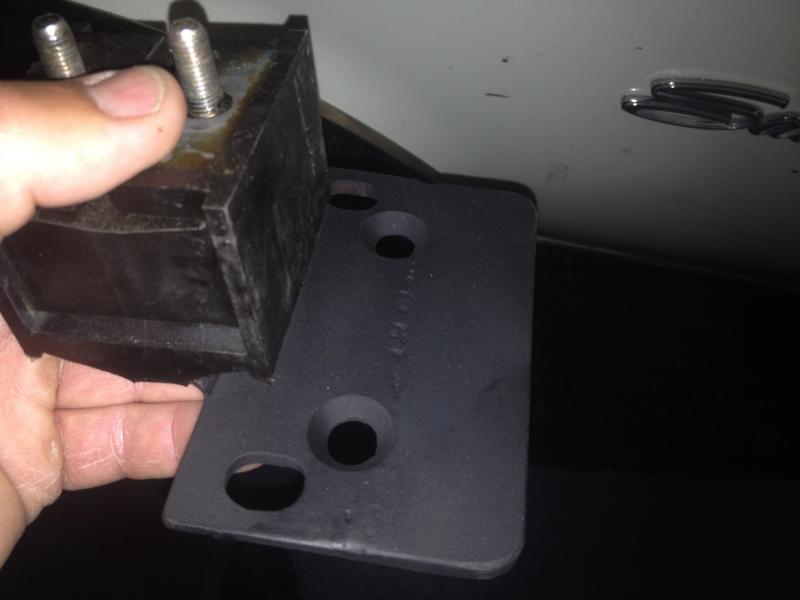

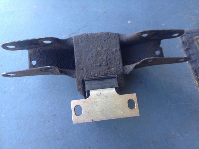

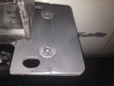

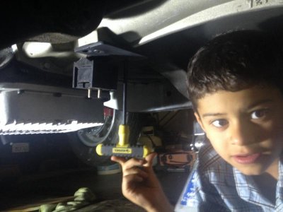

So today i started looking at this cross member thing again and came to the conclusion that the cross member does not need to be modified...but by turning the "Original Trans Mount" 180 Degrees gets it really close... yes the 1965 cable style mount with the 2 bolt at the bottom !!
But i do need to modified it...and i would much rather mess with that then the cross member for what ever reason i just feel better about it..have not done it yet but when i do ill post pics

Just elongate those holes a bit and your golden!

Almost...i think i need to weld on about an inch to the back of that mount then drill the new holes.. it's hard to see by the angel of that picture...but i also want to say that you gave me the idea of turning the mount around, another member was do something similar and you said to him to turn the mount 180 degrees and that stuck in my head knowing some day I'd be in that same Dilemma !!
"so Thank You 5.7 hemi !!"

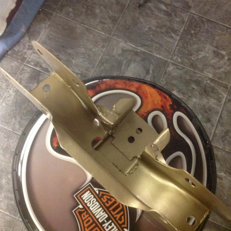

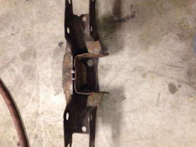

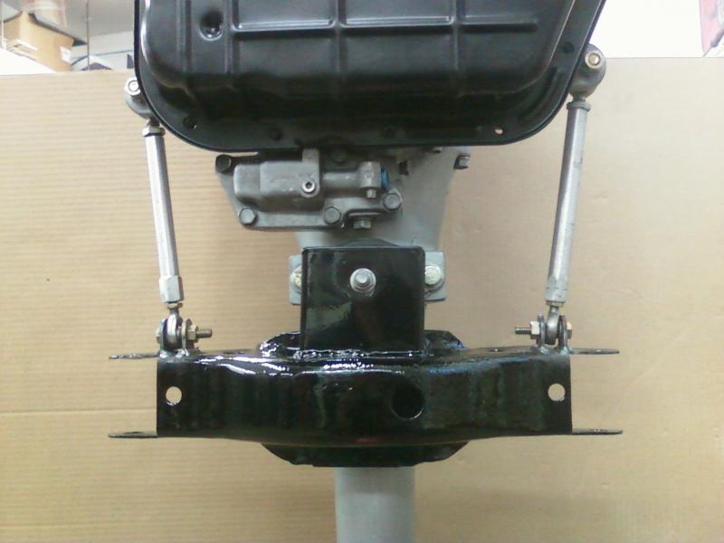

It's a stock 65 cross memeber gutted out and the new section was removed from a diplomat cross member. Uses spool mount

Okay boys using a later K-member with the latter trans just got a whole lot easier !! No need to modify the cross member...First take the original trans mount and turn it 180 Degrees-then just add 1-Inch to the original trans mount then simply redrill it to the latter trans bolt holes..." Yup !! That's easy"
