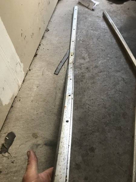

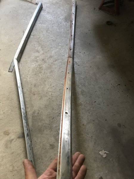

I have them but will need to be cleaned up or restored.I will take some pictures.
I have 2 sets both about the same condition. Will need to be re-chromed or painted.

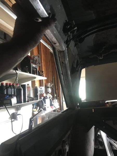

Sorry for my ignorance but is that the actual roof rail that holds the rubber for the windows or is it the trim that mounts over the gap between the headliner and roof rail?
These mount inside. The other ones are roof rails. The ones that the gasket goes in. I will hold it in place and take a picture for you. So you know what Im saying.

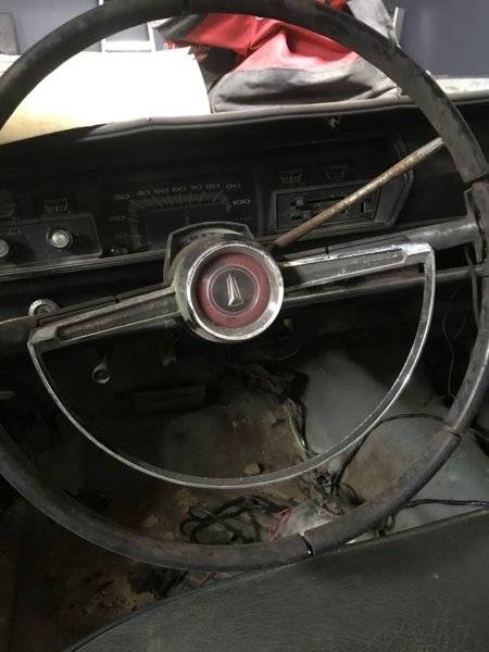

Let me see if I have a picture of the horn ring. I have 2 but one is in rough shape and would need some work. The other im using on my car. This is the one im using. Its rough too.
Was there one with just the center round hub or all like that? I have one like that on the 4 door parts car

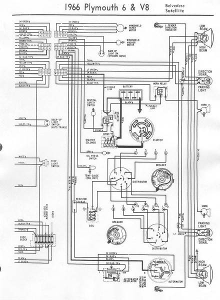

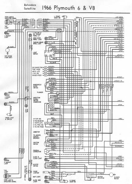

Go here and download the service manual for the 67 the manual for the 66 seems to be missing the electrical portion. http://www.mymopar.com/index.php?pid=109
Found these for the 66 Belvedere
Schematic A Here. Schematic B Here

The reverse light switch on a 66 bel is mounted to the steering column under the dash.
Just found them last nite, 2wires off trans (that was stolen also) to a 3 prong connector on inner fender, one prong is for oil sender. I’m hope a 66 like this is at Carlisle.
