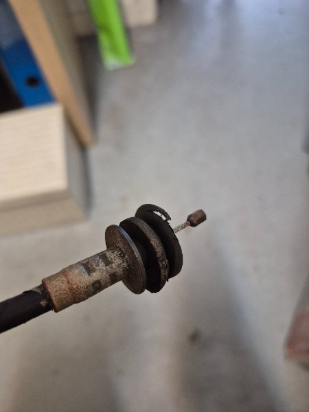

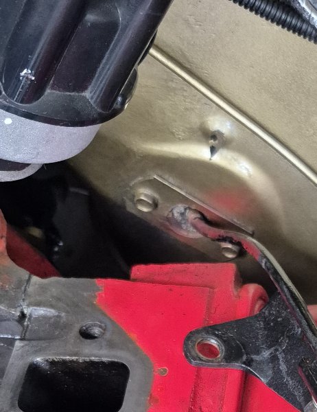

Hi Art,
I recently replaced an accelerator cable on my 66 Satellite. I believe it was original but may not have been. There was no grommet on the firewall side, but there was a foam type seal in there that fell apart when I pulled the old cable out. Photo attached of engine bay view and of old cable.
I replaced it with a Lokar cable and used a large washer on the firewall side to ensure no fumes could enter the cabin.
Not sure on the speedo cable question.
