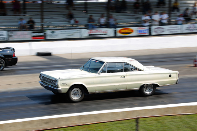

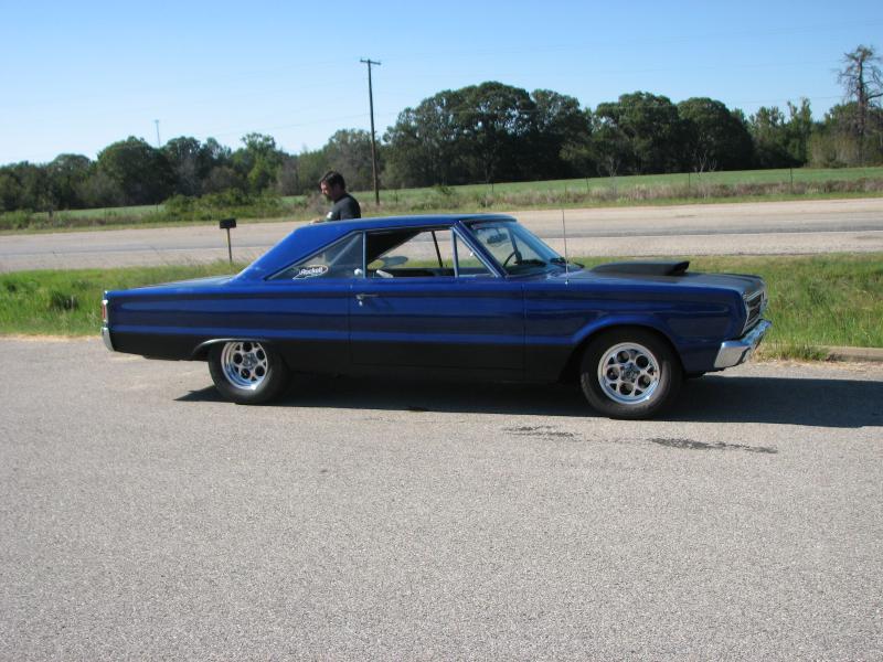

MG_4599.jpgIMG_2189.jpgThere were around 81,000 2dr 66 Plymouths, Belvedere and Satellite, built 47 years ago. Then there were like 750,000 440s built from 66-78 in everything Mopar put out. So over the years, how many of those 440's ended up between the frame rails of those Belvederes? My experience is, thousands! I've got a 66 Satellite and a 67 Belvedere in my driveway right now, both which received the Hot Rodders option sometime after leaving the factory!
