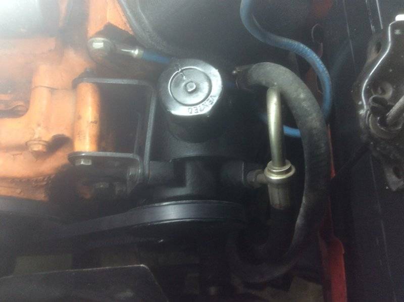

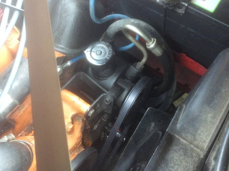

Should be the small TRW pump with Big block pulley which sits farther away from Pump housing.

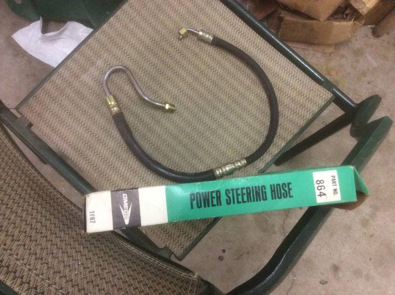

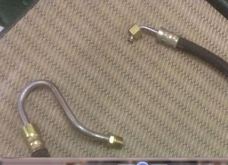

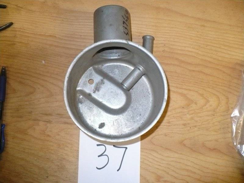

My 66 has a large return line 1/2" or so. If you have a TRW pump but with a 3/8" return, I have a can with the large return. They sell brackets on ebay. Some pictures PS hose. Hose isn't for sale.
The can if you need it I'll sell for a reasonable price.
Fran, what does your return fitting look like on the steering gear box?
It's 1/2" a little more really it's casting with a bulge at the end so when clamp it down it won't slip over it. Like a fuel line. In 67 they went to think 3/8" return line.

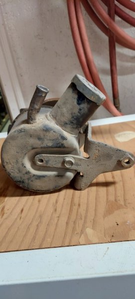

This is the pump that I found with some parts. It is a s small TRW (I believe). Any thoughts? I have some brackets also. Is there a way to measure to check and see if the correct pulley for the 426

On the pressure hose the 90 degree bend to steering box must be tight!
