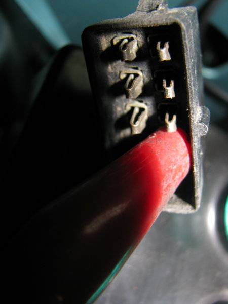

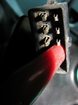

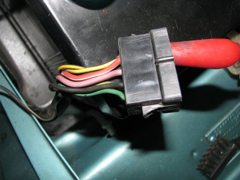

The first thing I will do is to check motors...
You have a connector on the side of the battery, disconnect the connector and localize the Violet and red with white stripe wire.
The Violet wire is for opening headlights .
The red with white stripe is for closing headlights.
Connect one side jumper on male Violet connector and touch the other side to the positive on the battery.
Both motors must open, don't leave the connector on after opening...
Do the same with the red with white stripe wire.
Then you will know if you have motors problems.
