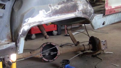

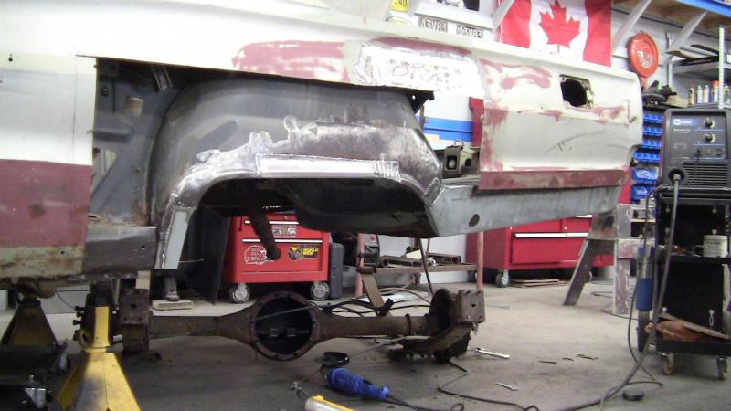

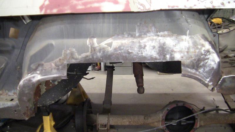

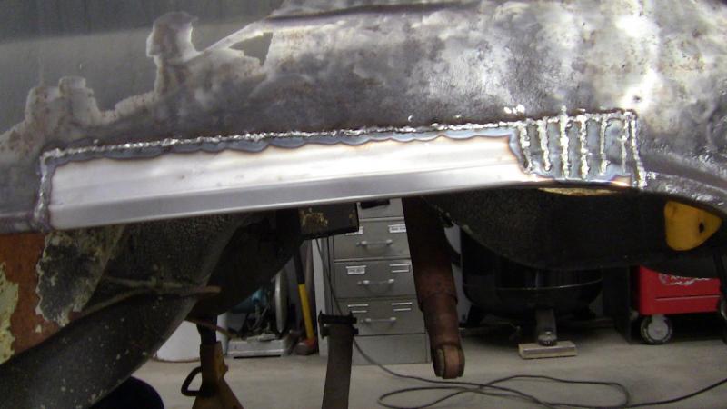

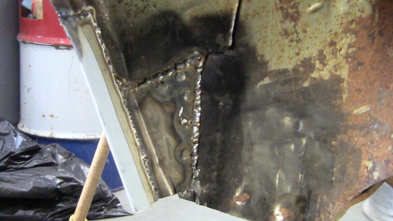

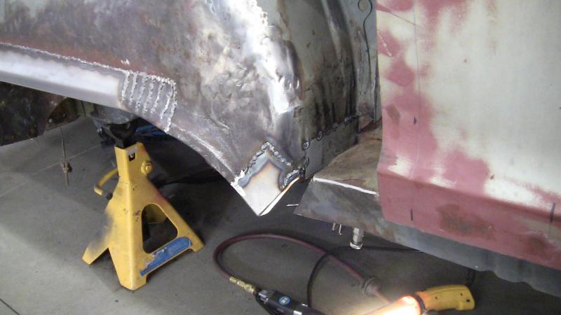

I repaired my Coronet. It's not professional, but hey it will work! Mine was fairly minor but with some patience, and acceptance that little is re-popped for these cars, I have managed to repair all my damaged areas. Oh, and welcome to FBBO.
Thanks for they reply. What did you use for the lip of the wheel house?
That particular piece was a cut off from the excess on the Sherman quarter patch sections. They were over sized for what I needed. It was flat piece so I bent it and shaped it and it's close enough for me. A lot of patches I make I cut pieces from an old hood I have here. The steel is rust free, correct thickness and basically straight so it's great for that. In fact, occasionally the bends in the hood can be used.
