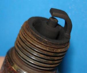

Around 40 degrees F. Car has been sitting in a no-run state for a few months now. Just checked plugs and they are fouled, pitch black. Going to replace them and try again.
40 degrees you need a working choke.
You can just hit the plugs with a propane torch and burn off the black.
No torch available... But many sets of new spark plugs and a gapping tool.
Will fix choke.
Plugs look like this. Would that explain some of the rough idle symptoms I mentioned in original post?
