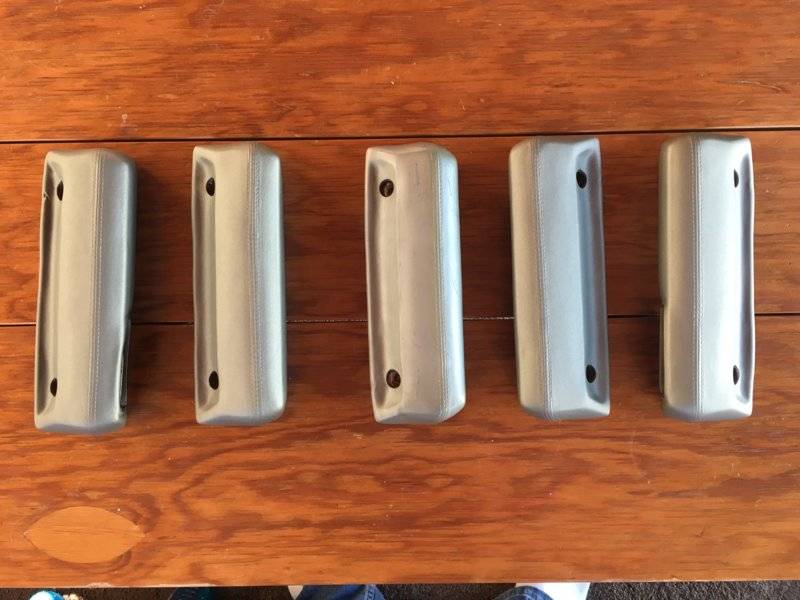

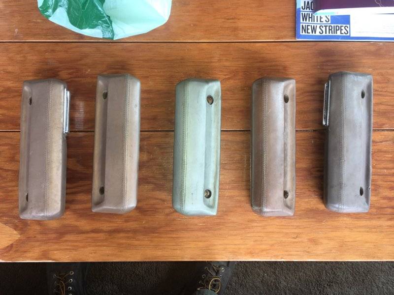

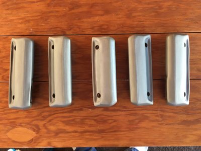

If you're still looking for correct color arm rests, paint them. I did and they came out great. Let me know if you need more info. The light was poor in the "after photo" but the center arm rest is the same one in both pictures and was cleaned, but never painted.
View attachment 595707 View attachment 595708
What did you paint them with and how were they prepped?
Vinyl and cloth paint—it had a special resin that makes it flex. Any good automotive paint shop should be able to mix it for you. Shot it with a cheap spray gun.
To prep, clean them really good—I used Gojo hand soap and a stiff brush, then wiped them down with alcohol to remove residue and oil from hands. Hung them with wire while I sprayed. It went on surprisingly easy.

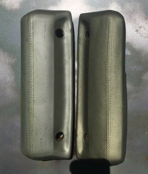

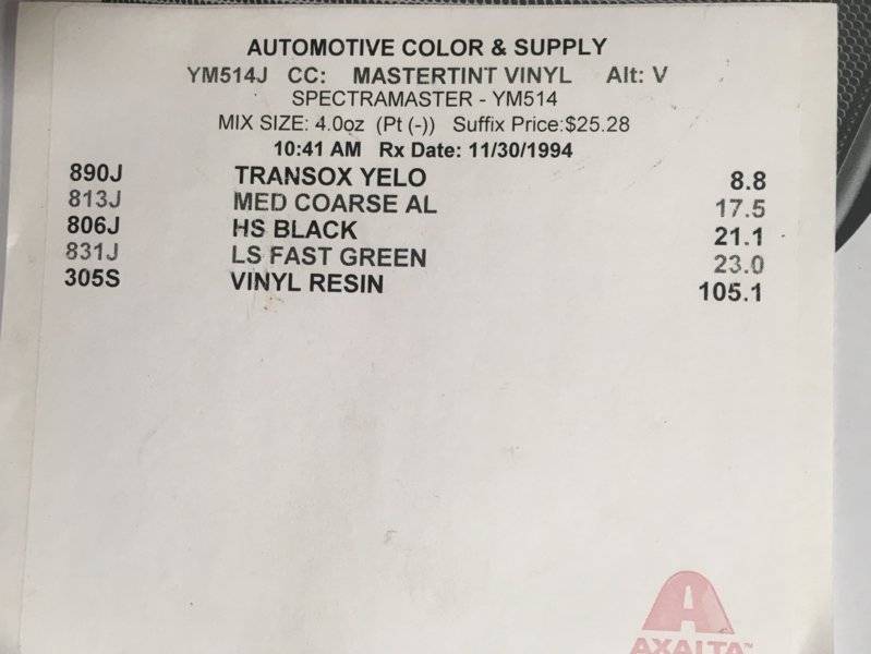

Here’s a better photo of the painted arm rest vs. original arm rest. And the paint code we used. Good luck!

You need to go somewhere that mixes paint. Visit your local automotive paint supplier. If you don't know where to go, ask a body shop or your local new car dealer service department where they buy paint.
Tell them it's for vinyl arm rests and they should know what to do from there. They probably won't have a 1966 614 gold color code, so you have to work with them to match the color. Hopefully the counter guy is good and he can use a book to find a color that's close. That's what we did. Otherwise, if you have a flat painted surface that is the same color, they can scan that, but they cannot scan vinyl--the texture in the material prevents it from scanning.
An auto body paint store should have vinyl paint, vinyl cleaner and vinyl prep. It's best to use the same manufacturer.

Take a sample of your vinyl to the paint shop, use the paint shop’s color match books, find a close match to your original color, & go from there. That’s what I did for Citron Gold.
