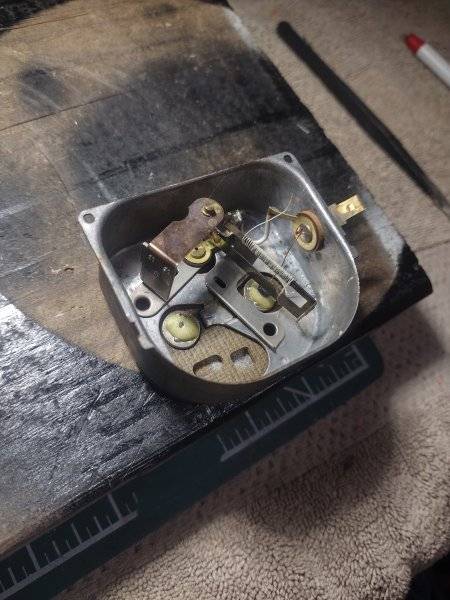

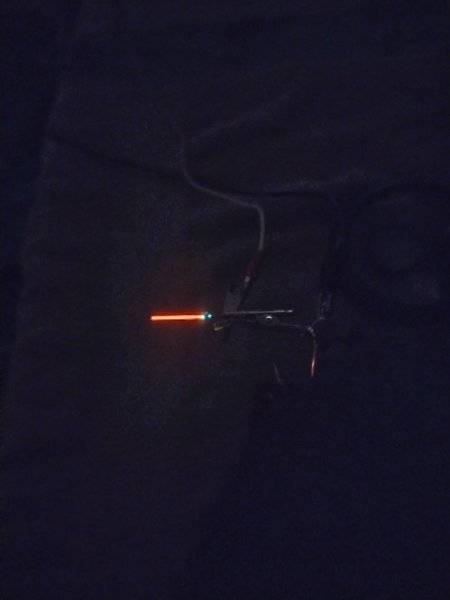

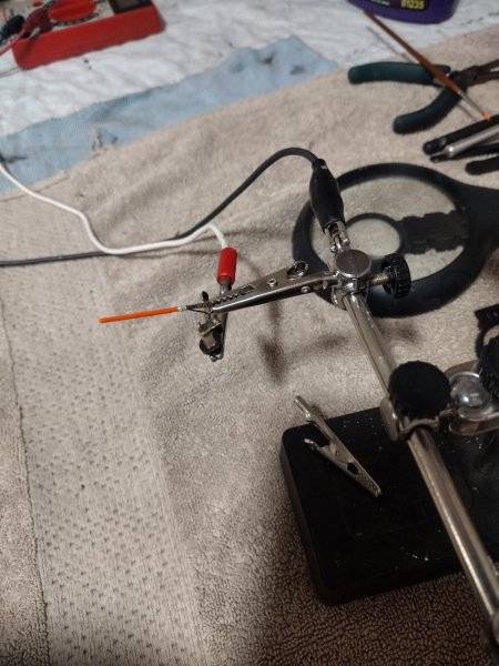

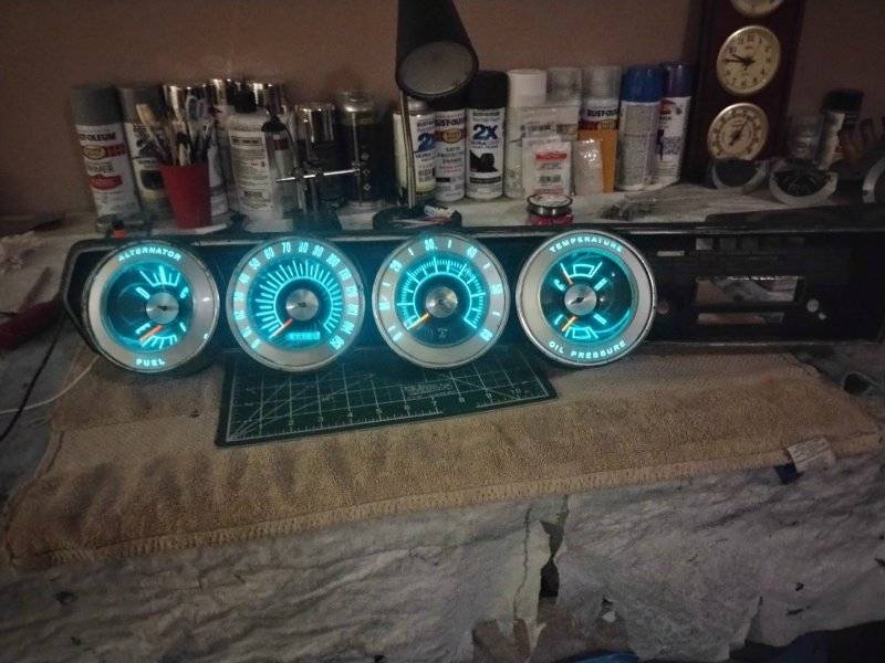

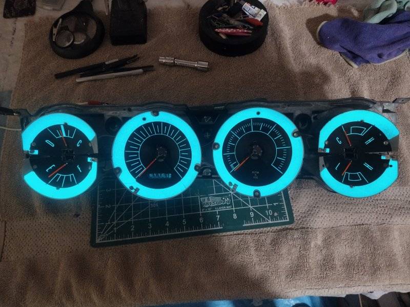

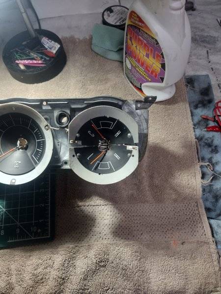

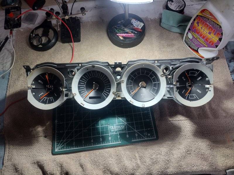

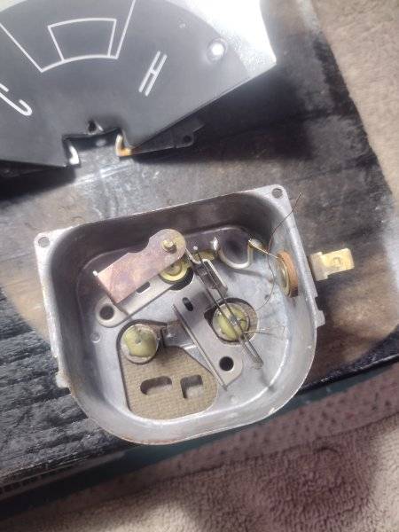

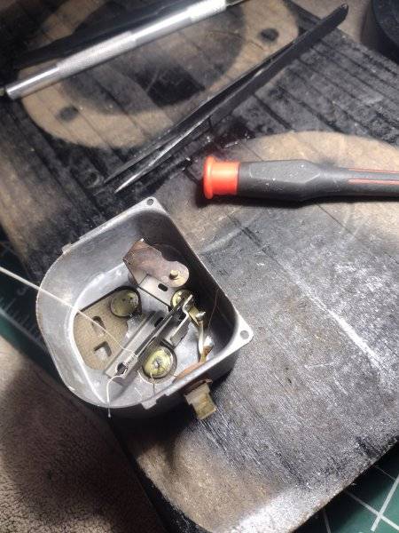

Another cluster done. Rebuilt fuel,oil,temp gauges, repaired fuel and amp needle, tach el, repainted all the needles, cleaned and polished faces and lenses. Finished it off with a Ivr3 Assembled and tested tonight and works like new. 1 problem I don't have a car for it. I built this one out of spare gauges I had. Guess I'll have to buy another car. Asked wife, didn't go well. It's a wall hanger for now.
Excellent "bench" work.
The gauges and headlights are the two main stumbling blocks in first gens.
It's good that people like you are maintaining them.
Skatpak does a great job on this. His procedures and pictures are going in my Charger manuals.
